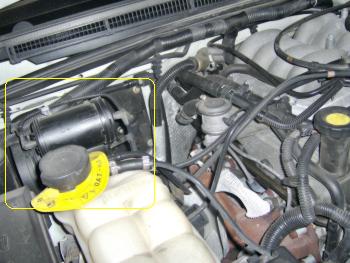

I just want to make sure before I order my engine. If I have secondary air I will have the pump and filter unit on the passenger side fire wall. Is that correct?

By that picture you have secondary air. You are correct about the pump. Also there are the 2 pipes that run along the back of the engine that attach to the SAI coming from the heads.
