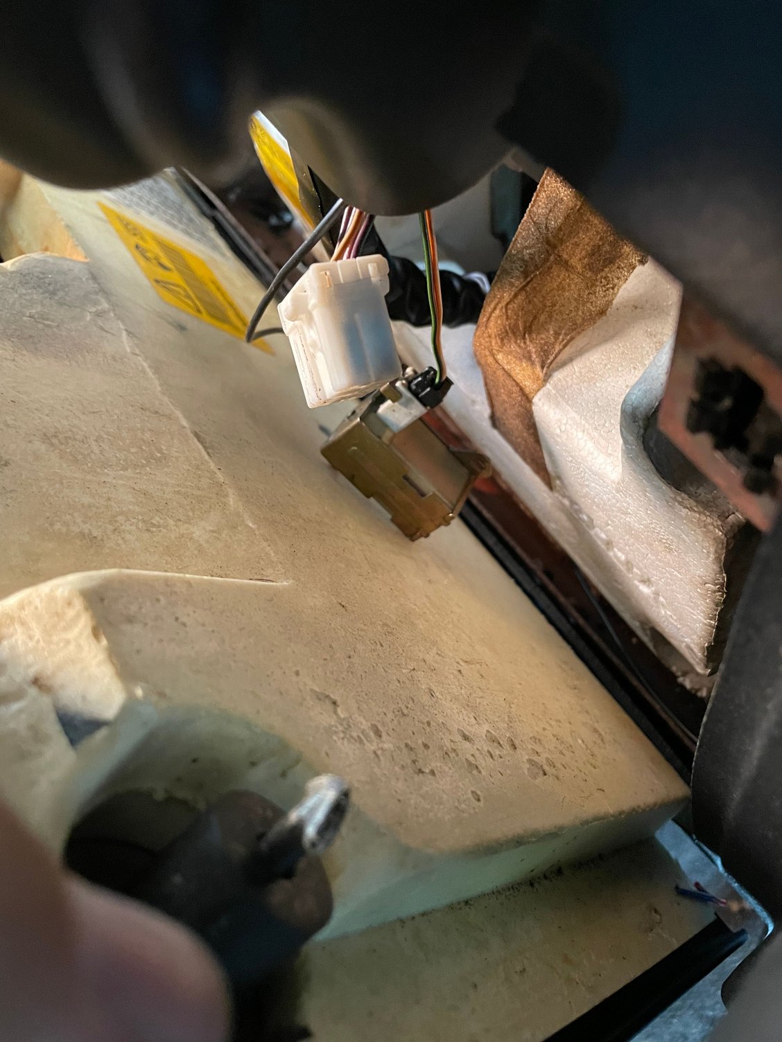

We just finished to change the evaporator on the discovery 2 2004. I have some plugs that I never found where to plug them back. I have attached a picture of those items. Also now I have a SRS light on the dashboard. Everything was done personally, no dealer was used just in case I needed to plug a scanner after the job was done. Then that never occurred.
Hope someone can help me figure this out.

I don’t think either of those are SRS, but I believe there is an SRS plug above where your picture shows.

Did you follow section 82-38 in the Rave? That might give you some clues.
I’m a little disoriented, but is the pic from the driver’s side or passenger? Is the passenger, there are a slew of connectors in there. Did you verify the HVAC works completely correct? Air distribution, AC, ECON, defroster, all that? That seems to be the place I’d start.
