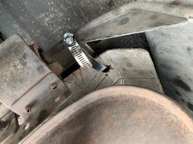

2. The noise started when I was decelerating or braking at slow speed (5-20mph). This was when I got home.
I thought it was the exhaust shield cause it was loose. I just added a clamp cause I didn't want to tear / remove tar to tighten it but it wasn't it.
Here's a video, sounds like it's by the transmission but it only happens during deceleration or slow speed... 5-15mph...
