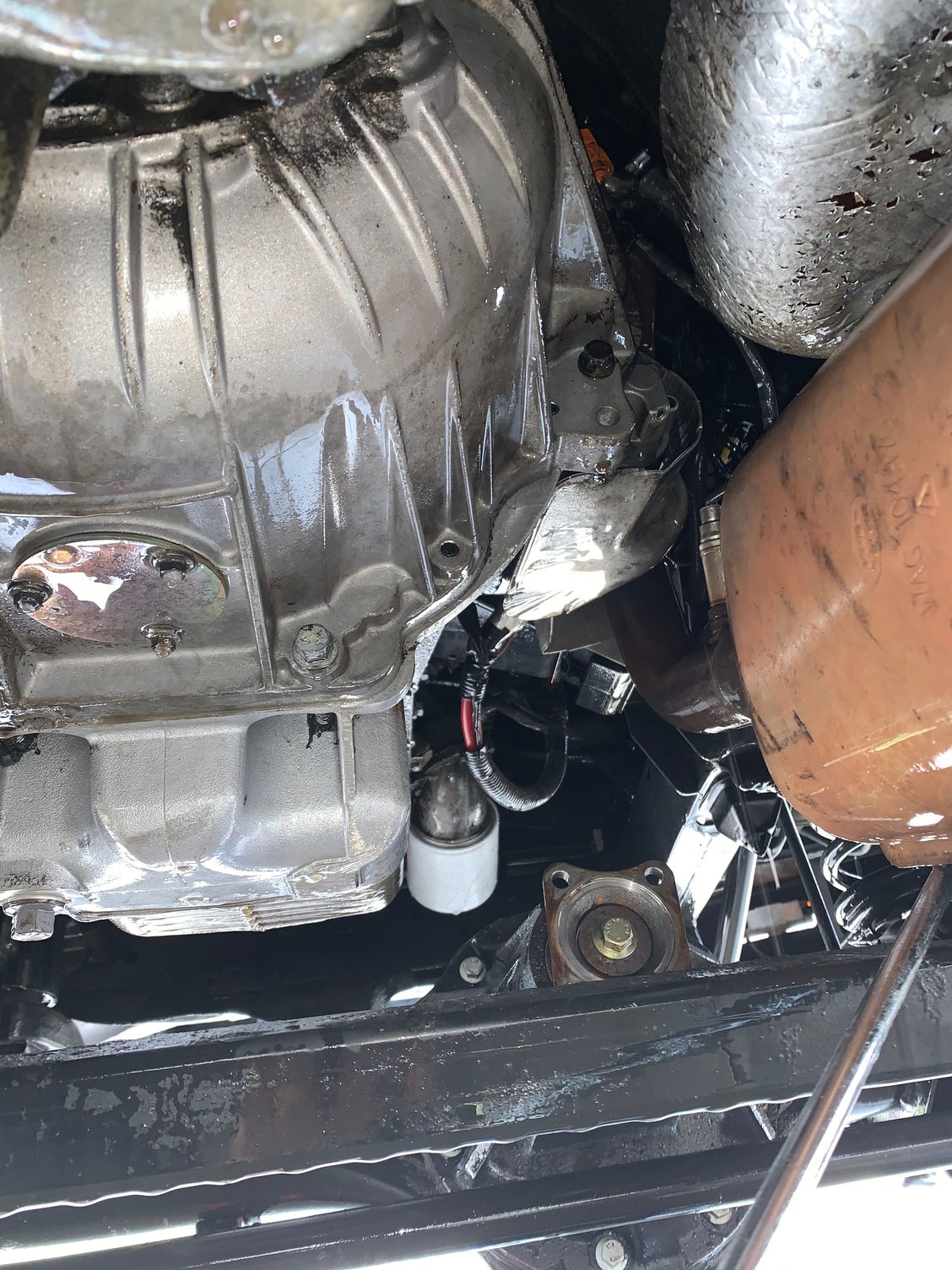

You got a photo? I’m trying to figure it out. Found a 10mm on top but I couldn’t move it at all.
Old Jan 11, 2021 | 02:34 PM
  #27
mollusc's Avatar
Joined: Nov 2015
Posts: 3,560
Likes: 834
From: Staten Island, NY
Post #10 in this thread:
https://landroverforums.com/forum/di...e-chime-88478/
The "nipple" is the piece sticking up towards the front of the unit in that photo, poking through the round cover with three bolts holding it in place.

  #28
GoRoll's Avatar
Joined: Sep 2019
Posts: 207
Likes: 42
From: Bay Area, CA.
Thank you.
That is difficult to access. I will just wait tomorrow to install my new shaft and go from there first.

Old Jan 12, 2021 | 07:14 AM
  #29
mollusc's Avatar
Joined: Nov 2015
Posts: 3,560
Likes: 834
It should be really easy to access if your front shaft is out. Maybe try it when you swap them over just so you can confirm that it's functional.

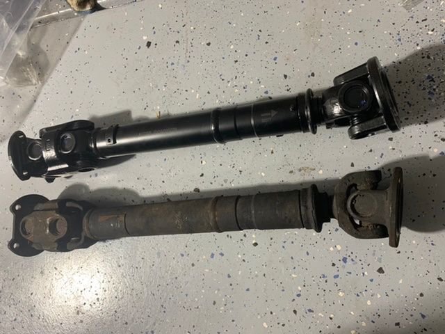

Old Jan 12, 2021 | 07:08 PM
  #30
GoRoll's Avatar
Joined: Sep 2019
Posts: 207
Likes: 42
From: Bay Area, CA.
Replacement is here. I’ll be installing this tomorrow.

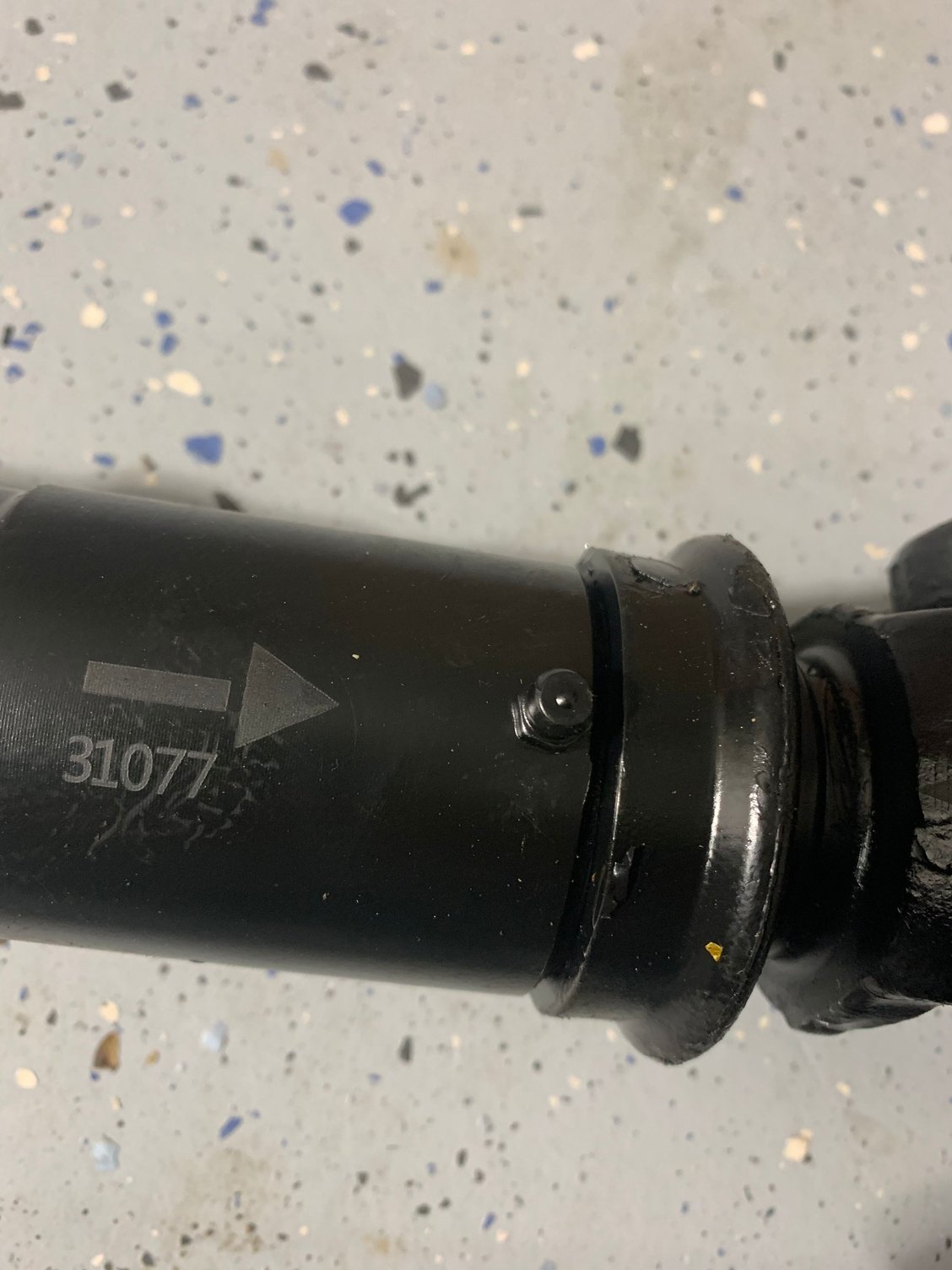

is there where you grease it?
