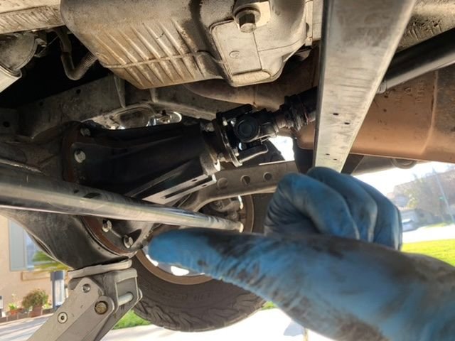

That is shaft extension grease zerk.
it’s the u-joints you should want to be able to grease.

Good news, but l wouldn't stop there. Still change axle(s), transfer case and trans fluid. Trans fluid and filter is a somewhat different process than most, so read up on changing before you tackle. Also, you should have a grease zert on the front joint of the rear shaft, grease that also.

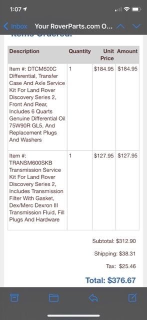

That’s my next step. I ordered all of it.
i could’ve bought it elsewhere for cheaper but AB gives us so much information of how to that we need to support these guys.
