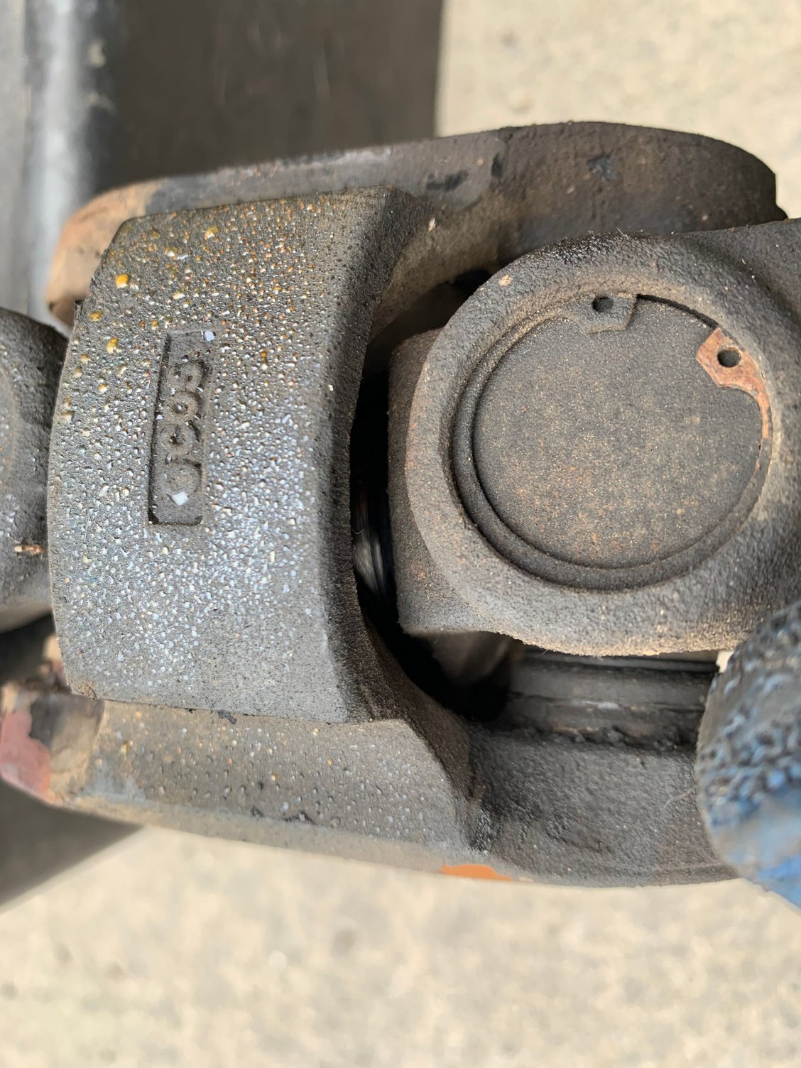

Waiting for it but today I pulled the front shaft just to inspect it...
not even sure how to inspect it lol but seems like the middle bearing is super loose.
My plan is to replace it.
Change all fluid.
But here’sa video.

The u-joint in the front section of the cardan joint looks froze up. The way you have it laying, when you remove your hand the cardan joint should be dropping under it's own weight, but it looks like it is not. You should be able to move each joint right/left and up/down freely. The discoloration of yoke lobes/ears seems to suggest it might be frozen too.
thanks.
I'm changing the shaft and all the fluids next week. Hope that fixes it.
