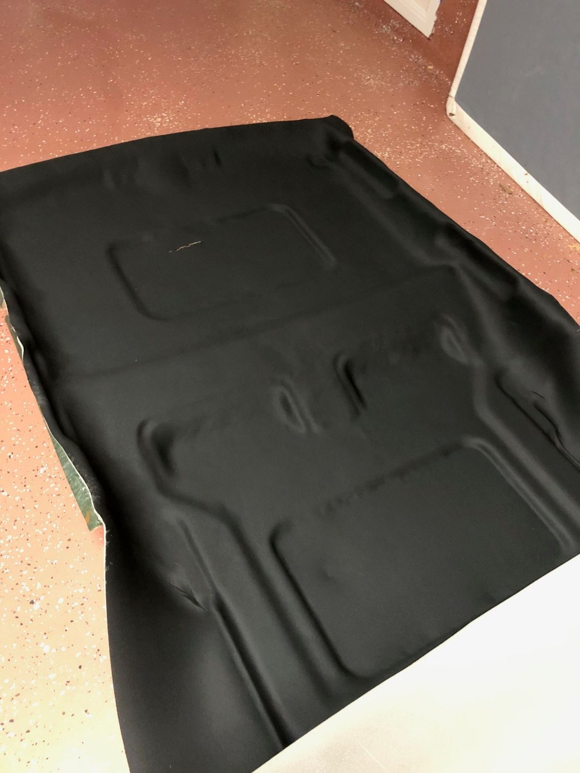

HI Having just done my head liner, I put it back on my own, I saw that mine wanted to bend down at the waist, were it was narrower, so I glued on a sections of plastic, 1/4 x 2 .5 inch wide and 15 inched long next to were the rear sun roof is at the back of the headliner, there are two blocks of a foam like material, mine both broke off with age , I glued on two small washing up pan scrubber,
OK so far next, i put the headliner in the car and rested it on the top of the seats and used cargo lamp to hold it up by just screwing on the two nuts by hand, next, I put the two push fit plugs in over the rear door right at the back,
next, put the headliner in at the front and knock on the 'A" pillar plastic moulding , both side , now the 'B" pillar plastic moulding , and its basically in , I fitted the rear large plastic moulding at the back next to hold up the back section, don't forget to reattach all your light wire as you go

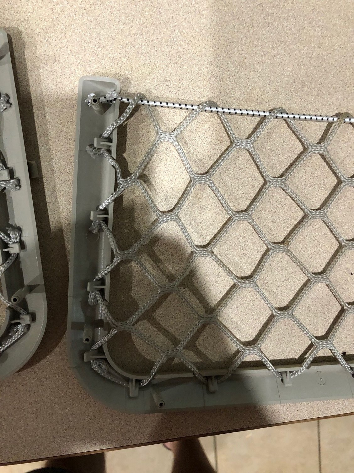

Originally Posted by fikus555
Nice video, but they doesnt show how they putted inside, and strange that they didnt redo the nets on the back.
I thought the same thing on the nets. For an upholstery shop I would have thought that would be a no brainer.

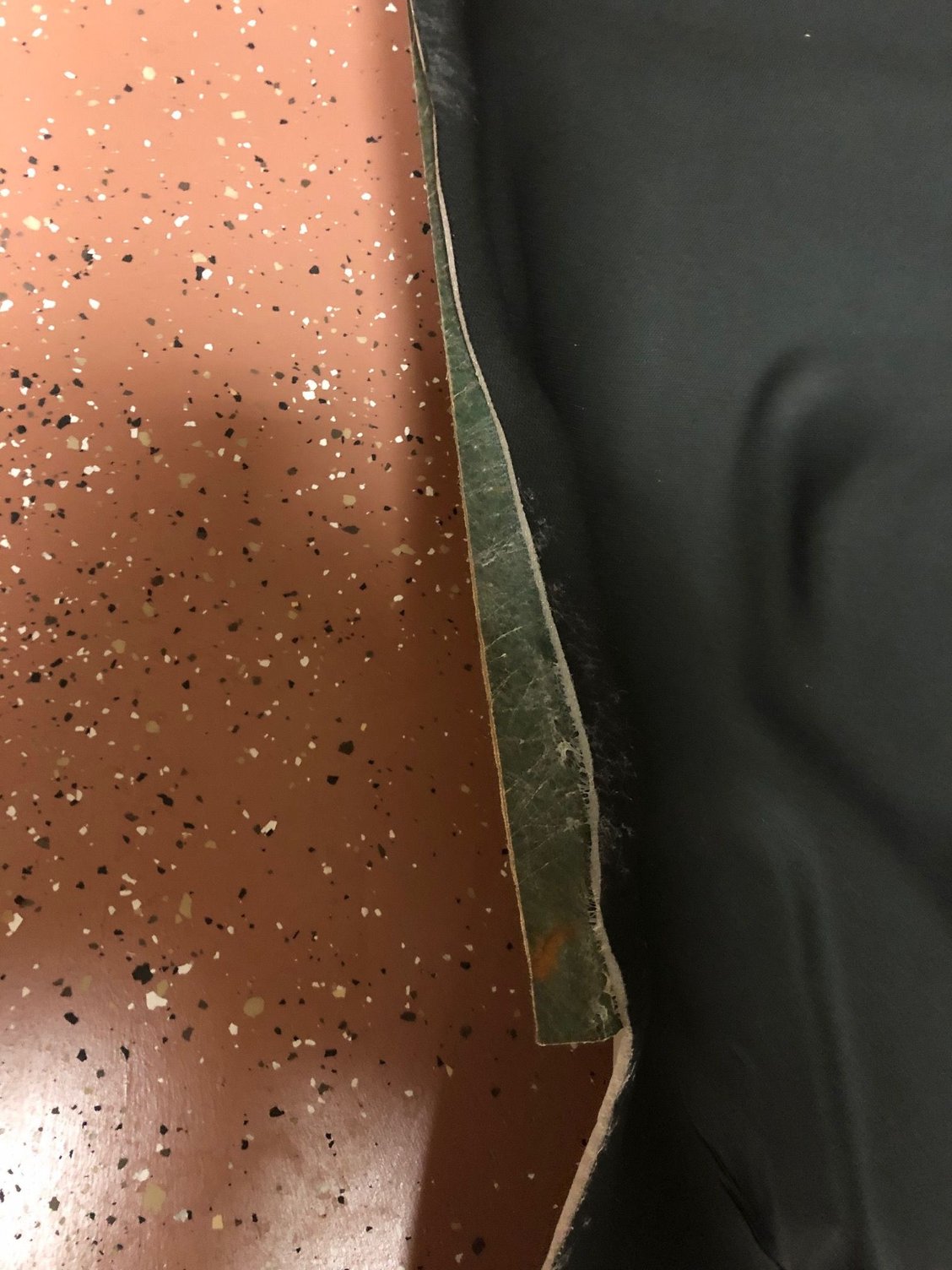

Nets was easy, but a little bit messed up with headliner. 60 inch not enough.

My headliner material was 72 inch wide from MARTRIM LTD UK, and I used a point soldering iron to burn the holes for the nets
