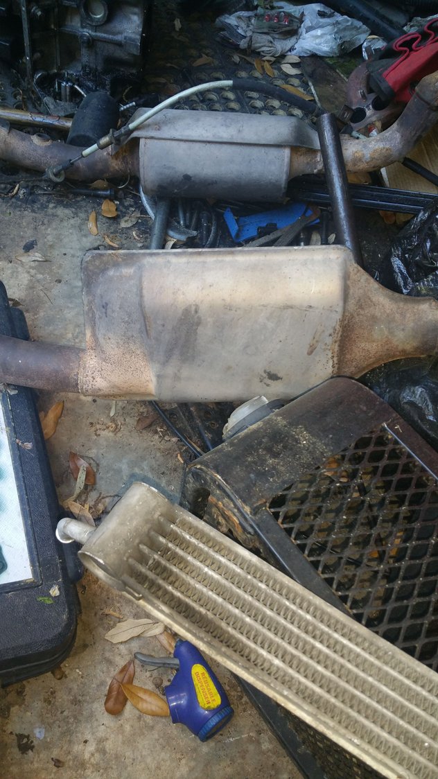

On my stock passenger cat, the pipe that comes from the manifold enters the cat at a higher position than the pipe that exits the cat and a straight pipe between them wouldnt work. Most of the aftermarket cats, well, ALL of them that I could find when I was in the market, required a straight connection.

From my parts pile. Right to left from engine to tailpipe.
Sorry for the mess. It is the junk pile. You can see it is not a straight shot from the front to the back. The universal replacement cats I could find required a straight shot (or you could add bends in the pipe).
Honestly that cat is going on my list of ridiculous manufacturer choices because it is offset, cooks the driveshaft, and cooks the frame.
I just recalled that my Davico pipe was about 3/4 inch shorter than stock, too, which pulls everything forward and brings the loop over the axle in contact with the end of a bolt on the rear of the rear axle. When I am at idle it rattles and pisses me off! (reliving it). I've actually pulled on the tail pipe like a cow's tail to temporarily relieve the rattling.
That's it. Next week when I swap the engine I'm putting the spare, factory, pipe on.

Okay they just angled it with some couplings. That would work.
