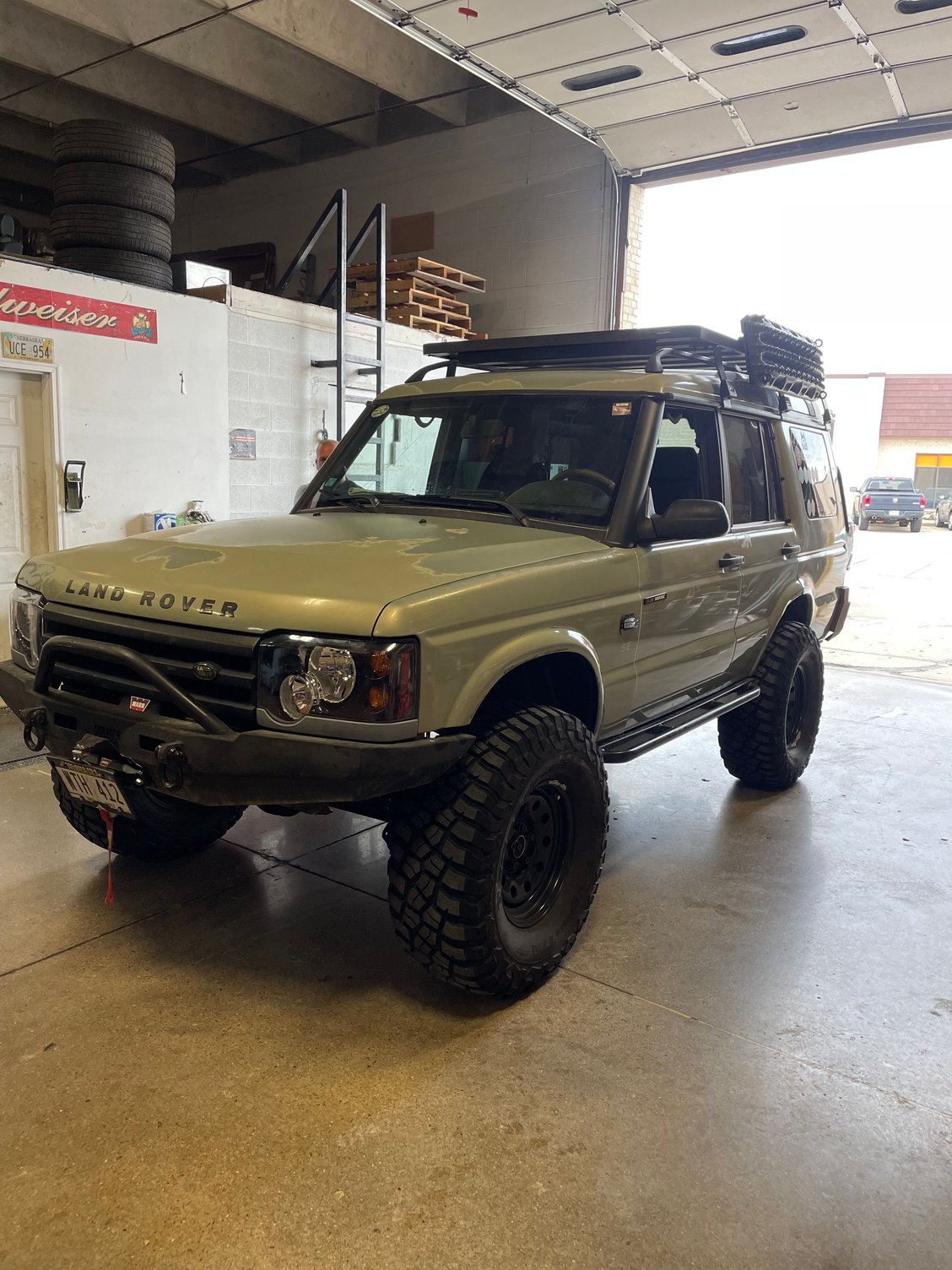

Heres my LS Swap with RTE Kit

thank you all for giving me a better understanding of what i truly need! That disco with a 4.5" lift is bada$$
My car has 185k miles on it and i am seriously debating if i should do a reman on the engine or if i should do an LS swap, how did you get that LS swap done ? Realistically how much should i expect to pay if i am doing most the work myself?
