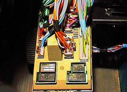

All of a sudden my blinkers and hazzards don't flash. When u turn them on they will flash once and then nothing. Any suggestions

The RAVE has electrical schematics in color. They point to the relays and IDM module that is part of the "electronic" backside of the fuse panel. If testing indicates a new one, a boneyard or a dismantler like Paul Grant would be better price than stealership.
The IDM module will resync with the BCM if key is left in position 2 for about 10 minutes.
But check all fuses involved first. Could also be the BCM which is a more complex problem. It needs a shop level computer to resync with ECU and odometer, etc.

Do these not have a normal flasher like the old vehicles did? That's a super easy and cheap fix if so.
EDIT: I'm reading RAVE and it appears it may not... Doh! Also, FUSE #14 in Engine Compartment seems to control the flashing.

Thx Supersport and Savanna it was the number 14 fuse
