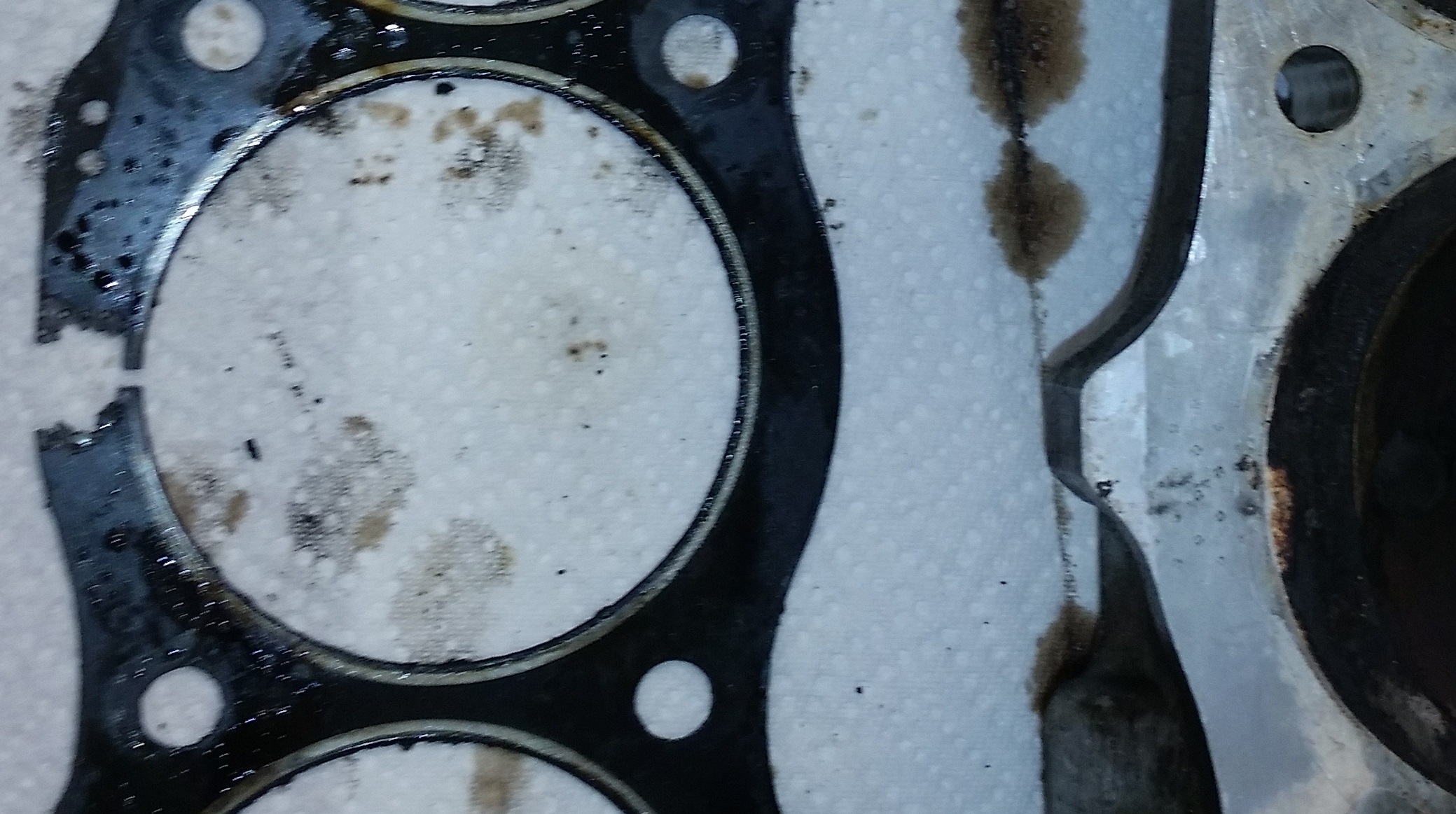

At the time, I saw that the gasket blow to outside had only burnt away the gasket and there were no marks on the head and block of any significance so I gambled (20:20 hindsight shows the bad choice) that the head did not need machining. But new studs, new gasket, and tightening just as instructed, it blows between cylinders this time. That needs fixing again....

Wow. You are the first person I've ever known who demonstrably needed to plane the heads. I have read that exhaust can cause a groove in the head surface or the surface of the deck, but never seen in even in three sets of abused heads (on separate engines). Very sorry to hear of your troubles after such an effort.
Also, my friend uses a honing stone on the block(fine side) to make sure its flat, you can see sections that are high and low when you pass the stone over the mating surface.
you take an expensive gamble when not decking the heads.
not only are you gambling with the $200 in gaskets and bolts,
but your gambling with 8 hours of labor, be it yours or someone else.
two pieces of metal bolt them together under torque and run them thru several thousand heat & cool cycles,
do you think they will warp?
I agree. I meant I've never known of anyone who said they weren't going to plane the heads, risked it, and then immediately had a problem. I've done both ways (planed and not planed, on different engines) and not had a problem either way. But I planed the heads on the one engine that mattered, which immediately ruined itself on other grounds.
