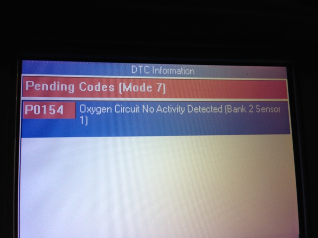

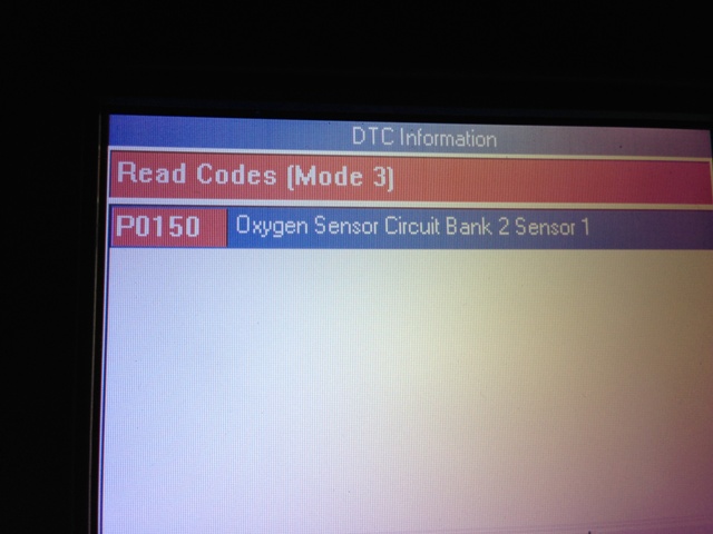

Have a 2000 D2. I replaced the RF O2 sensor this past May due to it being dead, probably from all the coolant that passed by when the HG blew, which I repaired and all is well on the cooling front.
My current issue is I get a pending code P0154 for that same O2 sensor, which was fine for several months, but when the check engine light comes on, it is giving me P0150. The codes would indicate a dead O2 I thought, but my ultragauge is showing voltage readings from it, however, it seems to be stuck on the low side ranging from .1 to .335 and never higher. I put another new Bosch O2 in and I got high readings from that one.
I can't find any exhaust or intake leaks and the wiring harness is clean and dry. Nothing seems explain why my ultragauge and OBD reader show voltage but the computer seems to think it's not getting anything.
Thanks for any insight.
