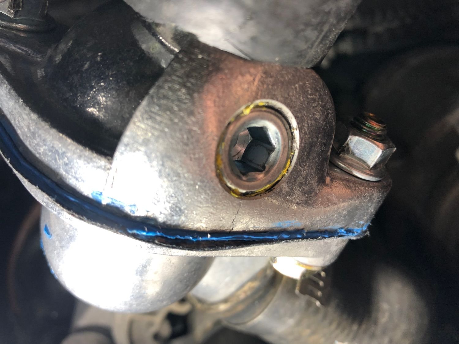

Been chasing a small leak for months in the housing. I had the reusable gasket and thought that was bad, but when I went to replace it I noticed the thermostat wasn't fitting into either side of the housing flat like you'd think. So I took my dremel and ground out a little of the side till the thermostat just fit flat and a little below the surface. Put it back together with the reusable gasket and thought it would be good. A couple days later noticed the same little drop of antifreeze under the engine. Thought it must be a bad gasket so I replaced that with rtv and a new paper gasket - a few days later the drip is back. Today I ran the truck up to temp and forced the thermostat housing up so I could watch the underside and after it got warm a little drop of fluid appeared between the port hole and the edge of where the two halves comet together. It's got a crack in the housing. If it were steel I'd just weld it up and grind it flat again. I don't have the equipment to weld aluminum. Has anyone else run into this? It's not even a year old . . .

I had something very similar a couple of months back. I chased it for months before I finally found that I had torn my reusable gasket when I changed to a higher temp stat for winter. I thought it was a crack in the housing as well and even reached out to Extinct on it. The lip between the opening and the port hole is so tight that it’s reasonable to expect the latter. I’d encourage you to try again with a proper gasket, or share some photos of the crack.

Oh wow, definite crack. Looks like the sensor port plug was overtightened a bit. No worries, we will warranty it out for you. Send an email to info@inlinethermostats.com with your order info so I get it sent out to the right address.

Thanks Extinct! I appreciate you sending a replacement part. My wife's rover will feel so much better!
