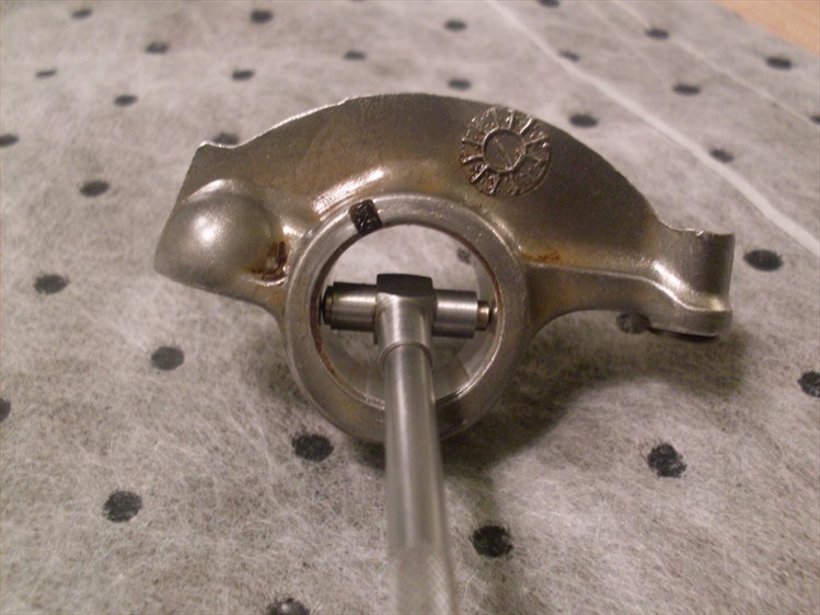

In addition to all they did, the oil flow into the valve train can drop the PSI as well, if rocker arms are worn. But do a mechanical PSI test for sure, you can buy or rent (?) a gauge.
