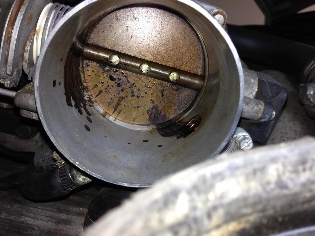

Buzz, in another thread you wrote:
Driver side PCV line does not have the filter. Normally filtered air from the throttle body is drawn thru the engine, picks up oil fumes, and out the passenger side valve cover and "oil separator" to intake manifold. Under some conditon flow reverses, and driver side valve cover vents oil fumes into throttle body.
If the flow was reversed, would this be what the inside of the throttle body would look like?

Yep. Think about it, no fuel is introduced until way past the butterfly valve. The PCV system is the source, if the passenger side is restricted the vac from the throttle body will slurp it right in on the driver side. You can spray that and use a rag on a stick to wipe up most of it behind the throttle plate. Would not want a big puddle sucked into intake. And through the bores that link to IACV and the PCV hose line. SeaFoam if you like also, but do outside, never in a garage or near a door where the smoke can get to a smoke detector inside.

Ok, I did clean the throttle bottle a couple of weeks ago but snapped this picture before I did. I was meaning to post it up and asked if it seemed normal. Now it makes sense. So is your advice to do a seafoam induction? Or can I just remove the passenger side hose and clean it out?

I agree with buzz completely, however, if the separator is clogged, it's not a reversal of air flow, as you do not have clean air going to the crankcase at all, so you end up with too much crankcase pressure when at idle.
Also, the picture you posted looks more like one big splat, as opposed to a constant flow of crankcase gases at that point. This would mean you had a (most likely sludgey) restriction on that side too, and once pressure built up enough, it was pushed through.
