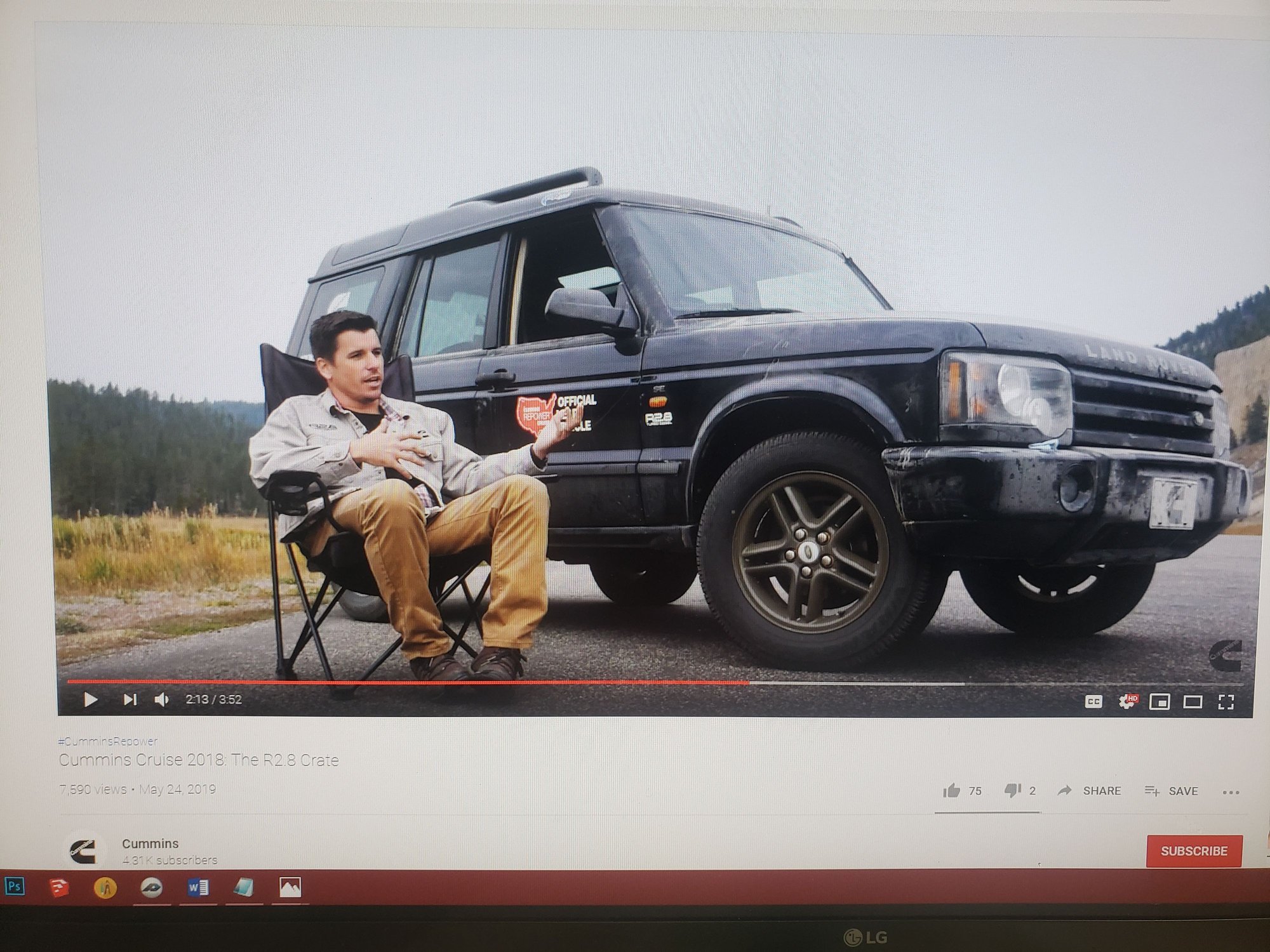

Hey I found this really interesting 3 minute video from Cummins. It showcases a land rover discovery and it seems like a 2003+ model based on the headlights.
they repowered it with a Cummins 2.8 and they're making it seem like it's a simple plug and play conversion.
I'm sure that's not the case but let's say money aside how feasible will this be?
Link:
https://youtu.be/Ktp1G17V67w​​​​
I'm weighing​ out all my options, I'm going to contact Cummins and see what they can provide for my disco and if they offer financing
