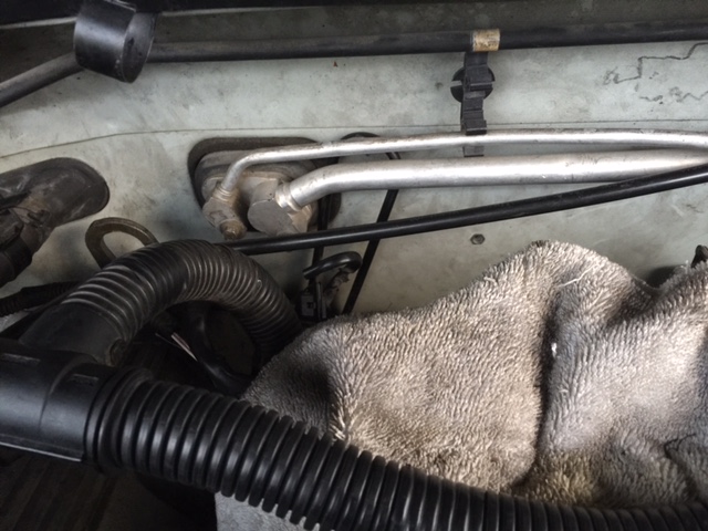

So I am changing the spark plug wires in my Discovery. I have removed the coil pack and see two black plastic tubing hoses.

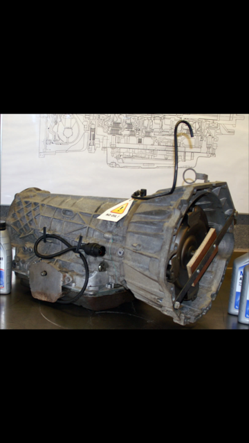

One I identified as the transmission vent. I will have to repair this line because it got on something hot and completely melted it closed.
The tubing I am trying to identify is the small black tubing that goes up the firewall behind the AC lines and then loops back down. You can see it in the picture... what is this line?
BTW, the person who designed the coil pack location is sadistic!!

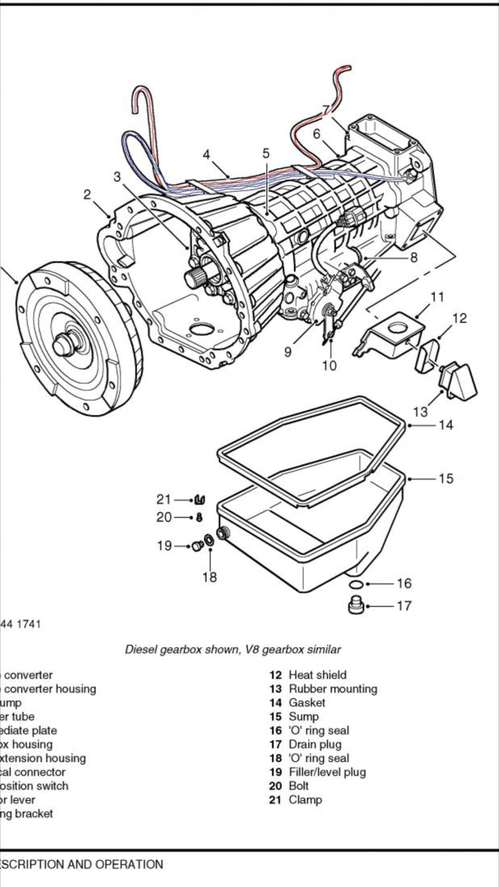

Looks like another vent tube that comes from the back of the trans and loops up and back to an open end.
Looks like it is the blue tubing in the picture below.
