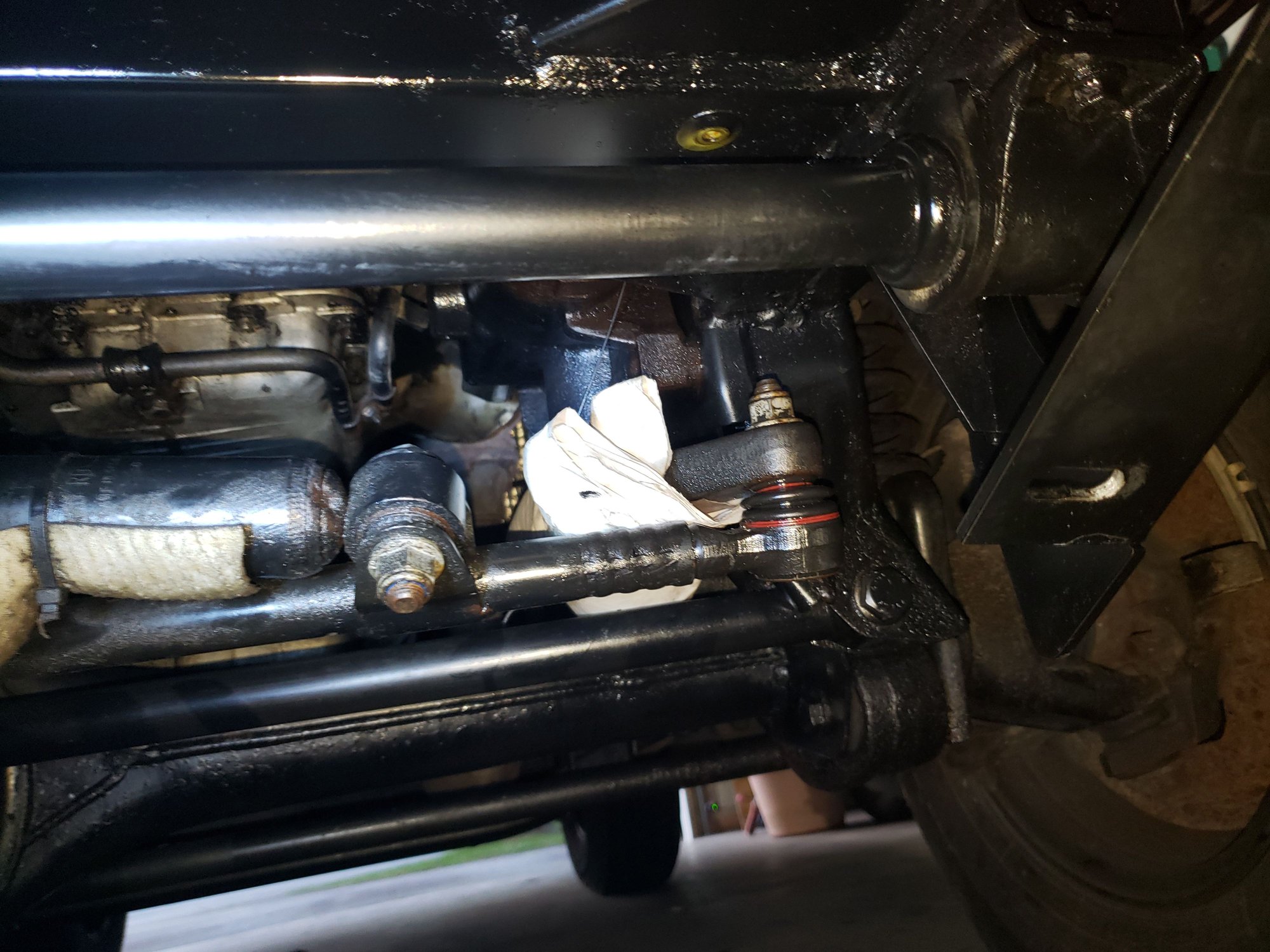

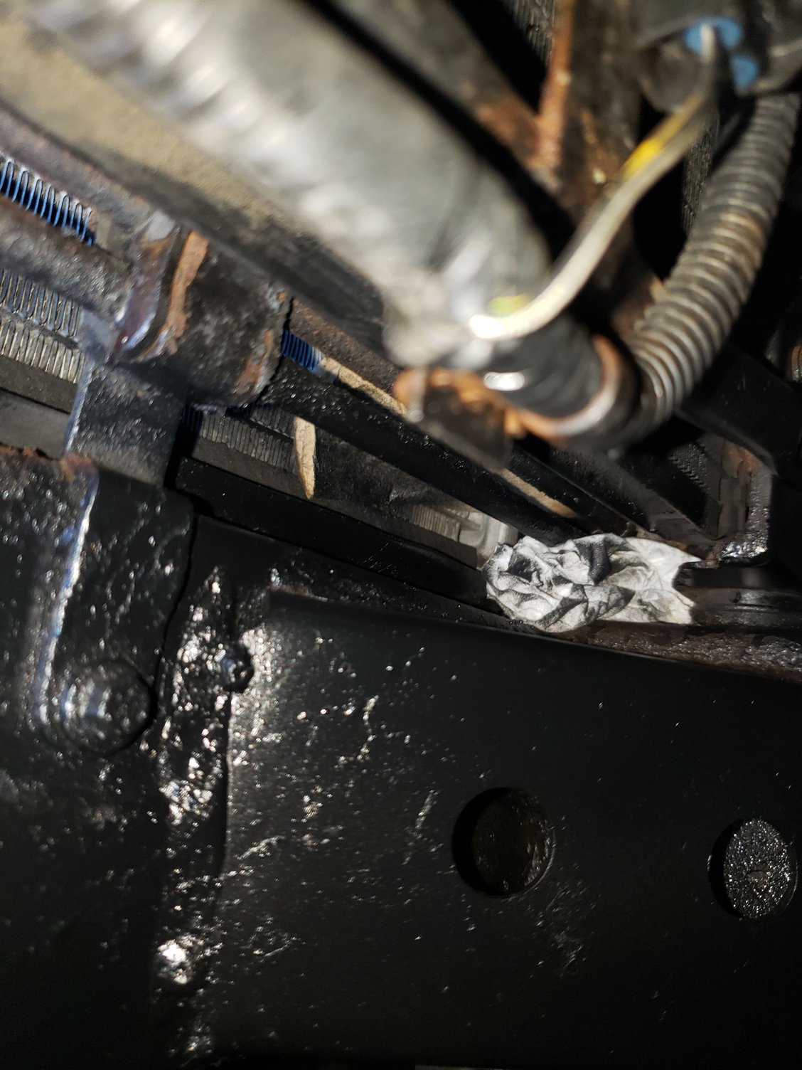

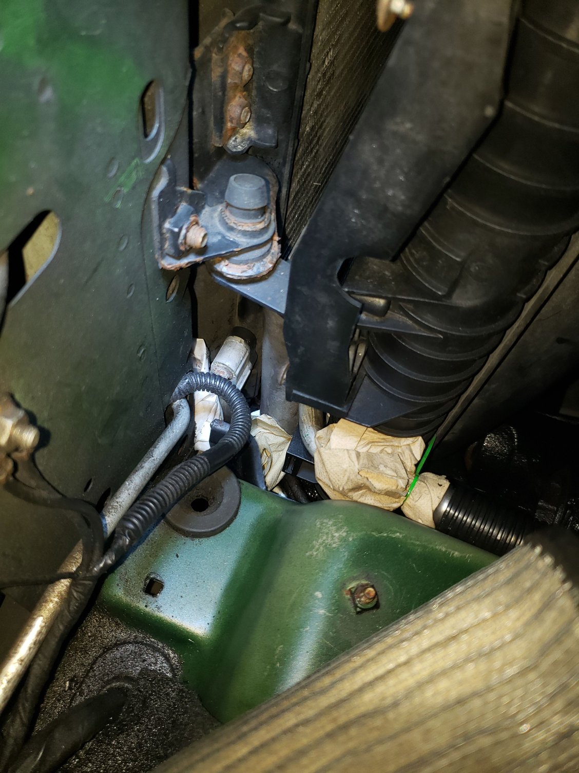

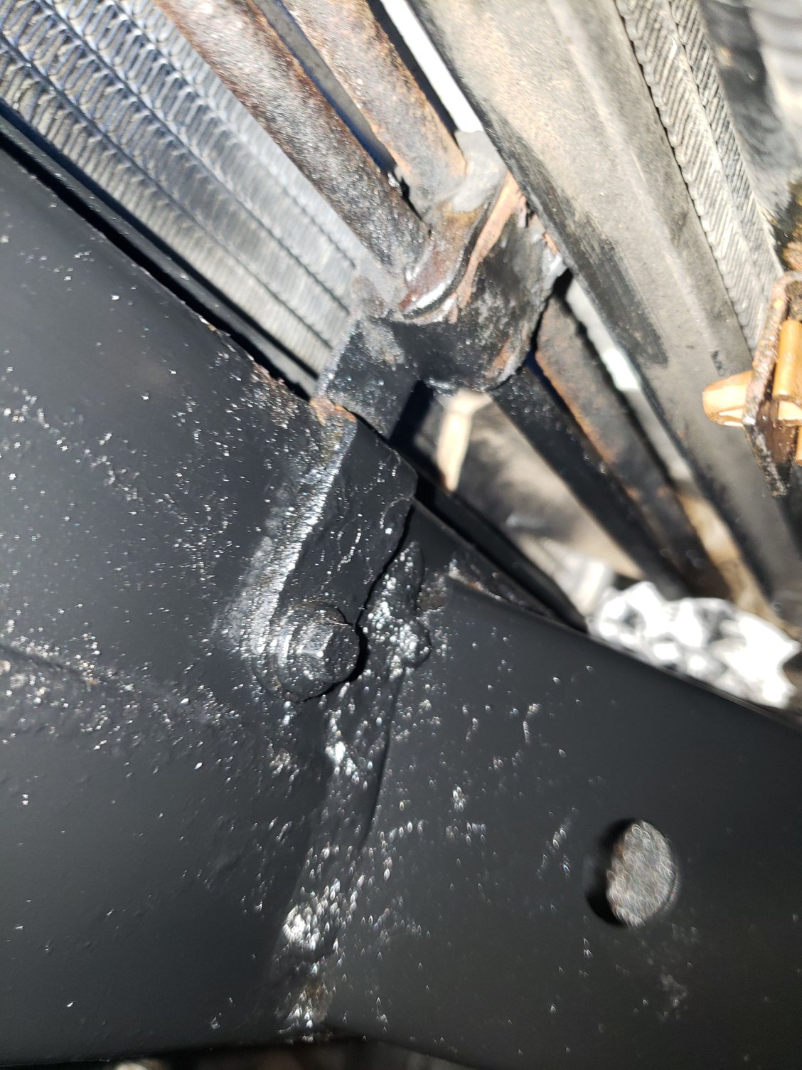

I am still a getting a leak, although not from the pump. It leaves a drop or so a day. Seems to collect on the steering guard, that is removed in these photos. It appeared to collect on the left hand, lower corner of rhe guard. Likely just gravity pulling it from somewhere higher.
I cleaned everything, and wrapped the junctions in paper towel and Zipp tied in place to see if i could find the leak. Everything is dry, except for the steering box, which is vaguely generally wet, it could be leaking but how would the fluid go up to get on the steering guard? Must be from above the steering guard, most likely the high pressure hose. The high pressure hose is bone dry, except for the section behind the radiator at the left hand corner, 2nd photo. the photos show a few paper towels. which are dry.
the low pressure return hoses are bone dry, the tank is dry.
Short of a new high pressure hose, any other ideas? That is the only piece not replaced. If the hose is leaking the paper towels should be wet.

Mine leaked pretty bad, high pressure hose failed and fluid got in and around the frame. Seeped for a week or so. Not sure if that’s the issue.

Based on your pics I am thinking maybe your cooler line has a pinhole in it, looks pretty rusted.

Thanks, I ordered a new one. Must be the case. I have cleaned that area up several times this week and I just cant seem to nail it down. One major plus of a steel bumper is that you have access to all the under carriage with much more room to maneuver. Same with a the "cold" air intake. I think the truck sounds better, might be getting better fuel economy, which makes no sense, but seems to be the case. Plus there is so much more room in the engine compartment and its only one clamp to remove it altogether. Highly underrated.
