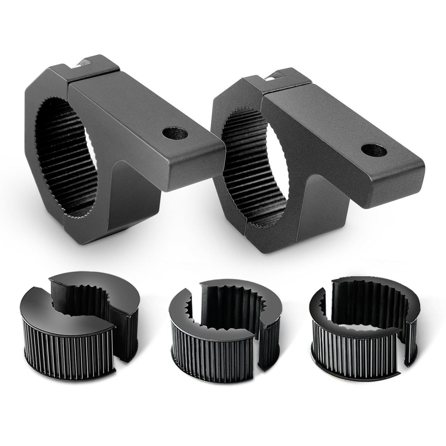

I wonder if these 2" diameter LED brackets would work on the front Disco roof bars for the QuickFist bracket?
https://www.ebay.com/itm/LED-Light-B...QAAOSwk95a7XIV
Attached Thumbnails Quick and Dirty QuickFist Brackets 04' D2-roofrackbracket.jpg
Old May 6, 2018 | 09:39 PM
CamelChad's Avatar
Joined: Apr 2018
Posts: 64
I wanted to get those originally. The 2.25” u-bolts I used are VERY snug. I looked at a few other pipe brackets and nothing really seemed large enough. I may modify it later if I can find a better bracket to attach 2 fists to the bolt.
