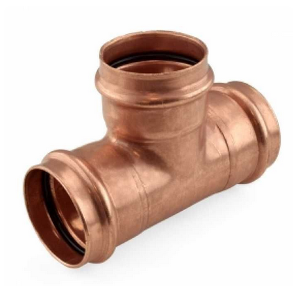

For sure there is a copper 'T' from plumbing supplies that fits. I did it and never failed.

Thats nice and I get better heat dissipation. Where can I find that? Also my radio decided to die on me. I checked the fuses on the radio and under the panel. I found a replacement. I have the harman kardon premium system. Will this upgraded replacement work in place of my radio part number XQD101390LNF.
