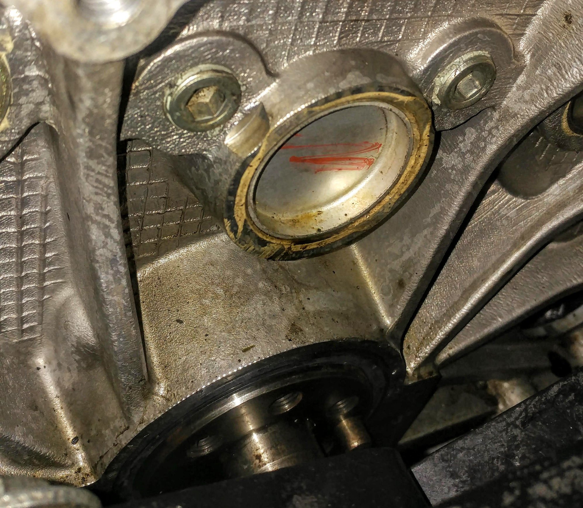

I have had two engines that have leaked at the rear cam plug, they drip straight down on the crankshaft so it looks like it is a rear main seal.
Almost impossible for the rear main seal to leak, as I explained here: https://landroverforums.com/forum/di...e2/#post711847
Huh, what do you do if the plug is the leak source?

At that point its a bit of a quandry. You can't knock it in to grab it because the cam is in the way. No real way to get it out. The oil is under pressure at that rear cam journal so unlikely that you putting sealant on the top of it would stop the leak. The plug is steel and the block aluminum so welding it in is not gonna work. I kinda doubt JB weld would seal due to the oil pressure. Have you considered pulling the engine instead of the trans?
If it was my truck I would exhaust all other possibilities including PCV mod and making absolutely sure the head, intake, and valve covers are not leaking. All of those present as rear main leak because the drip runs down to the same area. Clean the areas good with brake cleaner, oven cleaner, purple power, rags, etc. Make sure it is not one of those three. If it still leaks and you really want to fix it, drop the pan and do the crucifix seals. If it still leaks, I would pull the engine before I pulled the trans. At least then it is easy to do all the engine stuff you would like to.
