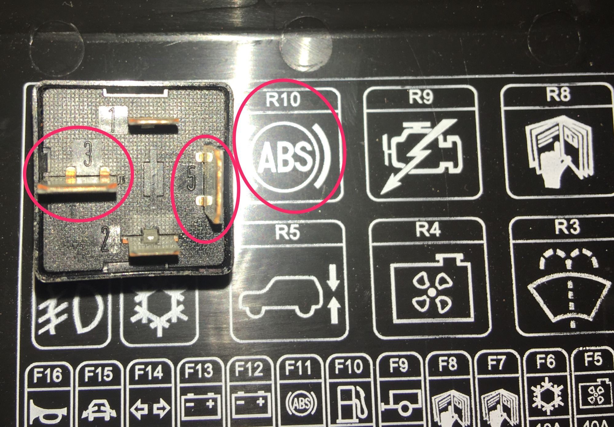

Originally Posted by Best4x4
You use the Front & Back terminals once you remove the ABS relay. Then you make sure your reservoir is full, climb under the D2, flip your toggle switch, ABS pump will run, open the bleeder and flush the old fluid or air out. Tighten the bleeder, top off the MC, and move onto the next wheel. Quick and easy way to power bleed a D2 without any fancy scan tools.
Thanks, that is awesome info.
