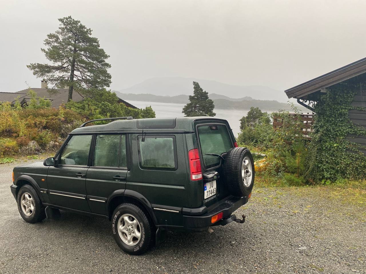

Hello everyone!
Two weeks ago I became the proud owner of a D2. Got it from Norway, drove it 1000 miles back home by myself, did the customs, bla bla bla. Amazing adventure, 10/10 would definitely do it again no matter what anyone says. Got to know the Disco as well during the run.
Now I am sorting with getting it to its former glory with all the oil leaks, electrical nonsense and minor neglect by the previous owners. Found that I need new front shocks, the old ones are completely dead.
So since I plan to make this a long distance hauler to drive around Europe and chill, yet I want to slightly lift it, but not so much. I started looking for options.
I found OME Nitrocharger +4cm front shocks and springs for an ok price in my country. Around 500 EUR.
Now I am thinking what to do with the rear. I have the original air suspension there, which was fixed properly not long ago. What should I do in my scenario with the rear side? If I lift the front, will the car be disbalanced? And how do I solve it, I heard that on RR L322 you can buy the rear Hight sensor. But what is my case with the D2?
And are the OME a recommended option for my car? Maybe there are better alternatives.
Again, My goal for the car to be an overlanded that can be driven from the Baltics to Italy ( example) without difficulty at 110 Km/h speeds with comfort and efficiency.
And my second questions is, what is the best place to order parts in Europe for the Disco? RoverParts has double Customs ( hello Brexit ). My country offers very poor options of shops.
I would be happy to hear your opinions experiences and where do you buy good parts!
Thank You for the help!
Here's a pic from the first day I got it still on its original Norwegian license plates since 1999.
