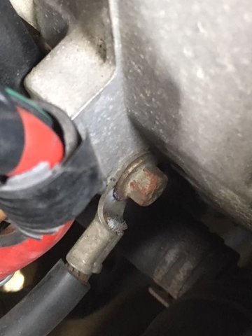

I checked the resistance from -ve battery cable to starter and it was 0. Judging by the looks of the ground it appeared good.
Here was the ground to body
This was the ground to the front of the alternator mount<br/>
The ground to alternator didn't look too bad but there was some corrosion and evidence of arching...
evidence of arching
signs of light corrosion
I cleaned up the end of the ground cable, but found it difficult to reach the face of the bracket where the ground had been attached. But right at the top next to the alternator was an obvious place to connect the ground cable. I sanded this back, sprayed with electrical cleaner and bolted it down.
