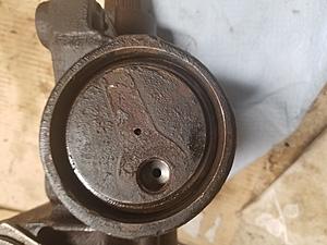

Here are some pics
big spring clip
Nylon rings on inner rack and worm gear
white nylon ring has o-ring under it
Attached Thumbnails Steering Issues-20170910_210939.jpg   Steering Issues-20170910_205627.jpg   Steering Issues-20170908_225049.jpg   Steering Issues-20170908_215702.jpg

more pics
Attached Thumbnails Steering Issues-20170907_220657.jpg   Steering Issues-20170908_211744.jpg   Steering Issues-20170907_220537.jpg   Steering Issues-20170908_220228.jpg

Why my steering box wasn't working as well as it should.
The white ring was broken.
I sheared a blue ring putting the worm gear back in. How, I'm not completely sure, as I was extremely careful with it. Oh well.

Bearings do Not come in the rebuild kit either.
Considering the extra cost they would be, and time to do it all, a remanufacfured, or good used box is the way to go.
