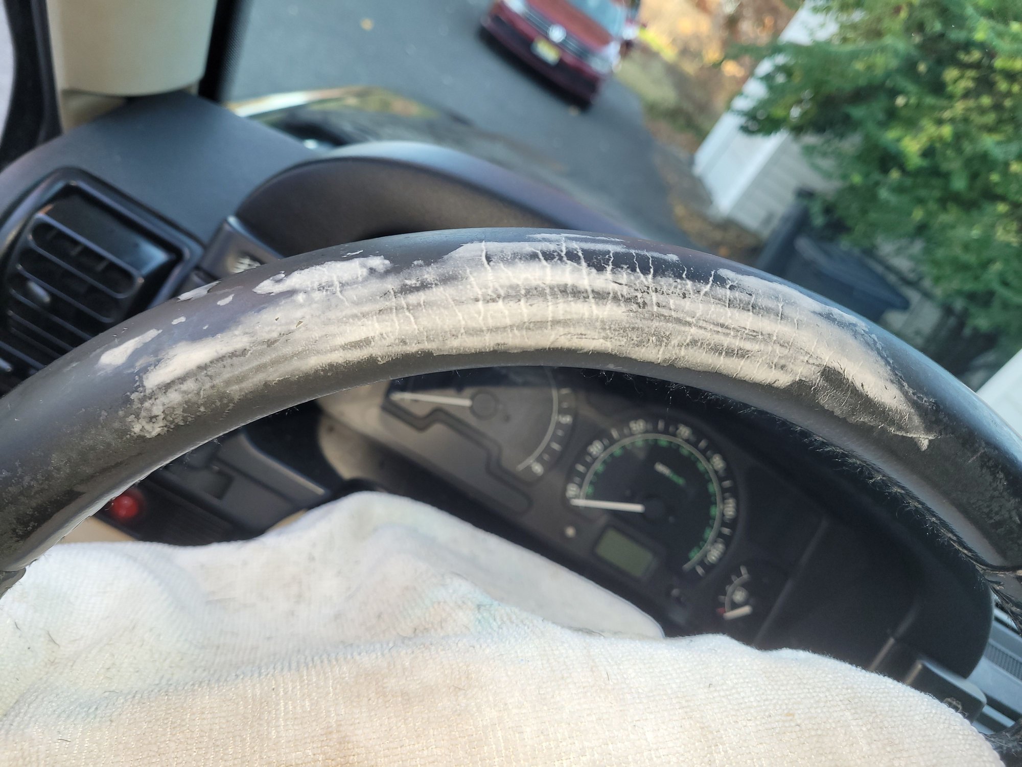

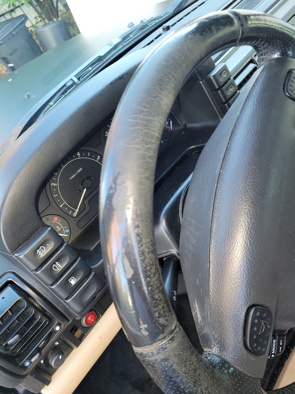

Mine is finally getting worn through. I am not in love with the idea of a wrap, making it thicker. Has anyone refinished one? Or, know what would be appropriate paint or whatever the finish is? Its the all black one and has worn to the foam at the top. I was thinking about using a leather filler paste on the foam to fill in the cracks, smooth it out and repaint it.
Any opinions on this idea?

I ended up giving it a go to repair the steering wheel. I looked around for one in much better shape and was not able to find one. I bought some leather repair creme from amazon and black gloss leather paint from Angelus. It turned out better than expected, I should get the gloss finish coat, but I will see how this holds up, it has been a couple of weeks. For $20 seems like a solid fix, only took about 30 minutes, including about 4 coats of paint.
