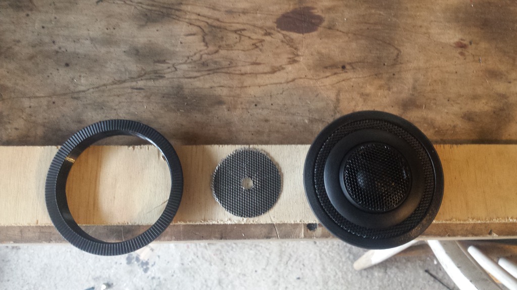

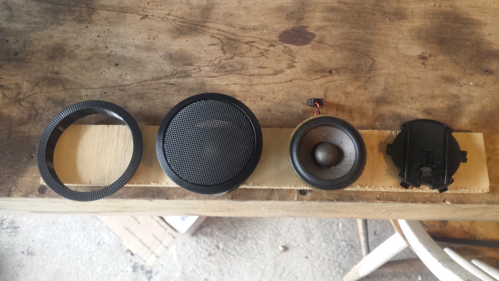

The stereo project has been moving a little slower than expected. Over the weekend I was able to bypass the amp with no issues. When I was looking to install the front speakers I found out there's no way for my to install the tweeters in the pillar like I hope. That left me with needing to find a good spot for them. I ended up taking the mid's apart, and used those to house the tweeters.
Here's the mid taken apart.
Here's the finished product. I used a 2" hole saw to drill out the center of the screen. It's not as clean as I'd like, but it looks OK.
