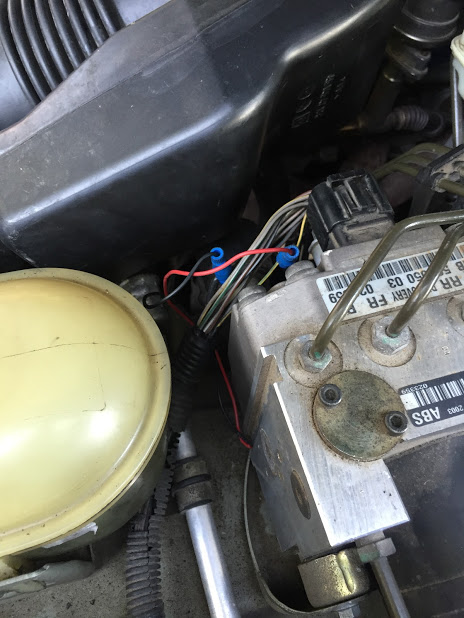

When you replaced the shuttle valve, did you do the modification described in the sticky?
Replacing the shuttle valve by itself will not rectify the problem, the problem is the connection from the shuttle valve to the abs wiring and can be corrected using the option b mod.

Does performing Option B cause the truck to not have ABS? Or does the ABS still operate as normal?

It does not stop anything from working, you are just bypassing the connection that is defective in the abs module. It is not usually the shuttle valve itself that is defective but the connection inside the abs. The shuttle valve sends a signal to the control module along with wheel sensors, etc. then the control module regulates the operation of the abs, traction control etc. You basically will wire the shuttle valve directly to the wire loom coming out of the abs, one of the wires of the two shuttle valve wires will go to the ground(black wire that comes out of the ABS, right below the multi-wire harness) and the other will go to the yellow/green wire that is in the multi-wire harness. It does not matter which wire from the shuttle valve goes to the ground and which wire goes to the yellow green, since they are only like on/off switches and are not powered.
