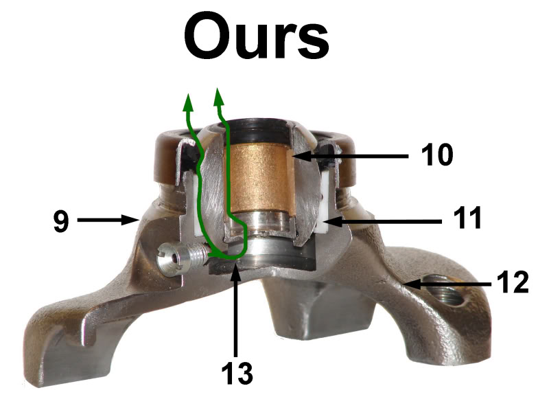

There should be a flat zerk for the centering ball. I don't have one, so I can't take a pic. You will need a needle fitting that goes on the end of a grease gun to get it. Looks kinda like a pencil. Do not just slather grease in there. There is a fitting...
Ok, found this. Right below where #9 is pointing, that is the fitting you need to grease...

I didn't see any kind of fitting like that... How about you Torancis?
I read your reply a little late, I did just slather some grease in there. I took it out for a drive and still no more noise.
