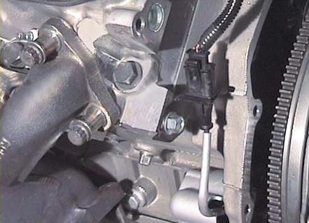

Posts: 16,322
From: Savannah Georgia
IMHO unlikely. People drive Rovers next to police cars, cabs, amatuer radio operators, and in city areas there is all sorts of RF (every frequency from DC to light). Their cars crank up. The cup does not have RF shield mesh around the edge. The wire from the sensor is shielded, but the connector certainly is not. I would wonder if you cleaned off some of the gunk, with brake cleaner or electronic cleaner. Anything that shorts across the wiring pair from the coil, or shorts it to ground would diminish the signal from the coil.
Now the signal is a low voltage AC signal, and that shielding keeps other noise from spark plugs, etc., from adding additional pulses and making timing jitter. But should not keep plus from firing at all.
If you have an pal in camp that is an instrumentation guy, he may have a portable oscilliscope that could be attached to watch the signal, which should look like attached .
Down here where it is warmer, the typical electrical problem with the CKP is that the coil opens up (bad solder joint, etc.) when engine block gets hotter after car parked for a few minutes. Won't re-crank until truck cools off. I'd bet that the same could be true in cold weather, a bad solder joint or connection can have a mind of it's own.
Attached Thumbnails Stuck in Northern Canada and need help trouble shooting!-ckp-external-pix.jpg
