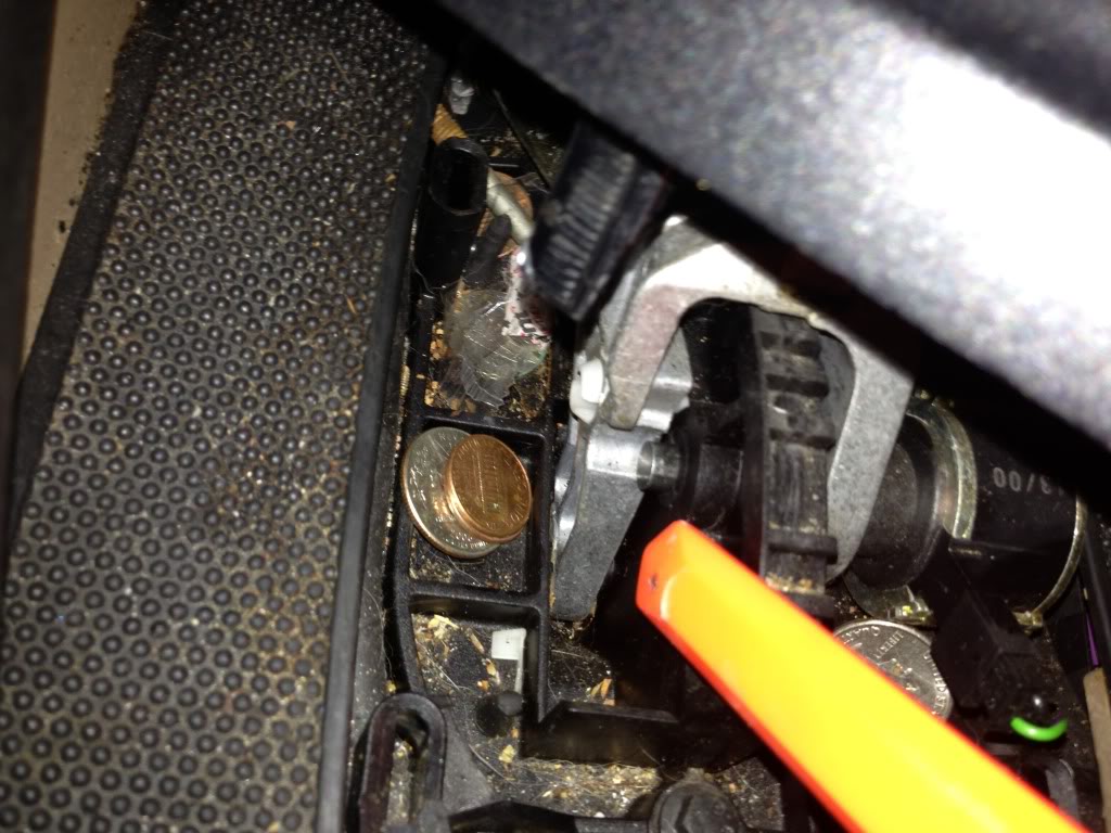

The bottom cooler is for the gear box. If the brake switch is broken and you're in a bind and have to get it in drive, you can wiggle up the shifter cover in the center counsel, and on the left hand side push in the solenoid keeping it locked in park. Here's a picture:
