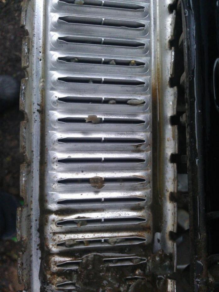

Water pump should have many miles left on it. If you have a healthy cooling system, with no use of well water and tap water, it will last longer. Once it starts to wobble the pulley it is eating aluminum, seal goes and it leaks out the nose. On left is model from 170K D1, D2 at 115K on right. The brown coating is stopz leakz, which as you can imagine will reduce the heat transfer (and may stop a minor leak). A new water pump can come with a larger bronze impeller, the stock is stamped stainless steel I believe.
Radiator can be checked for sludge by comparing temp on the fins from top to bottom in a vertical line, engine off and warmed up. If more than 10F spread, the lower rows will be cooler due to sludge buildup form Dexcool, corrosion, and stopz leakz.
The thermostat can have the tiny holes at top plugged with trash and that will allow less hot coolant to enter and warm up the stat to open. The 180 is a fresh start, and will have no trash.
