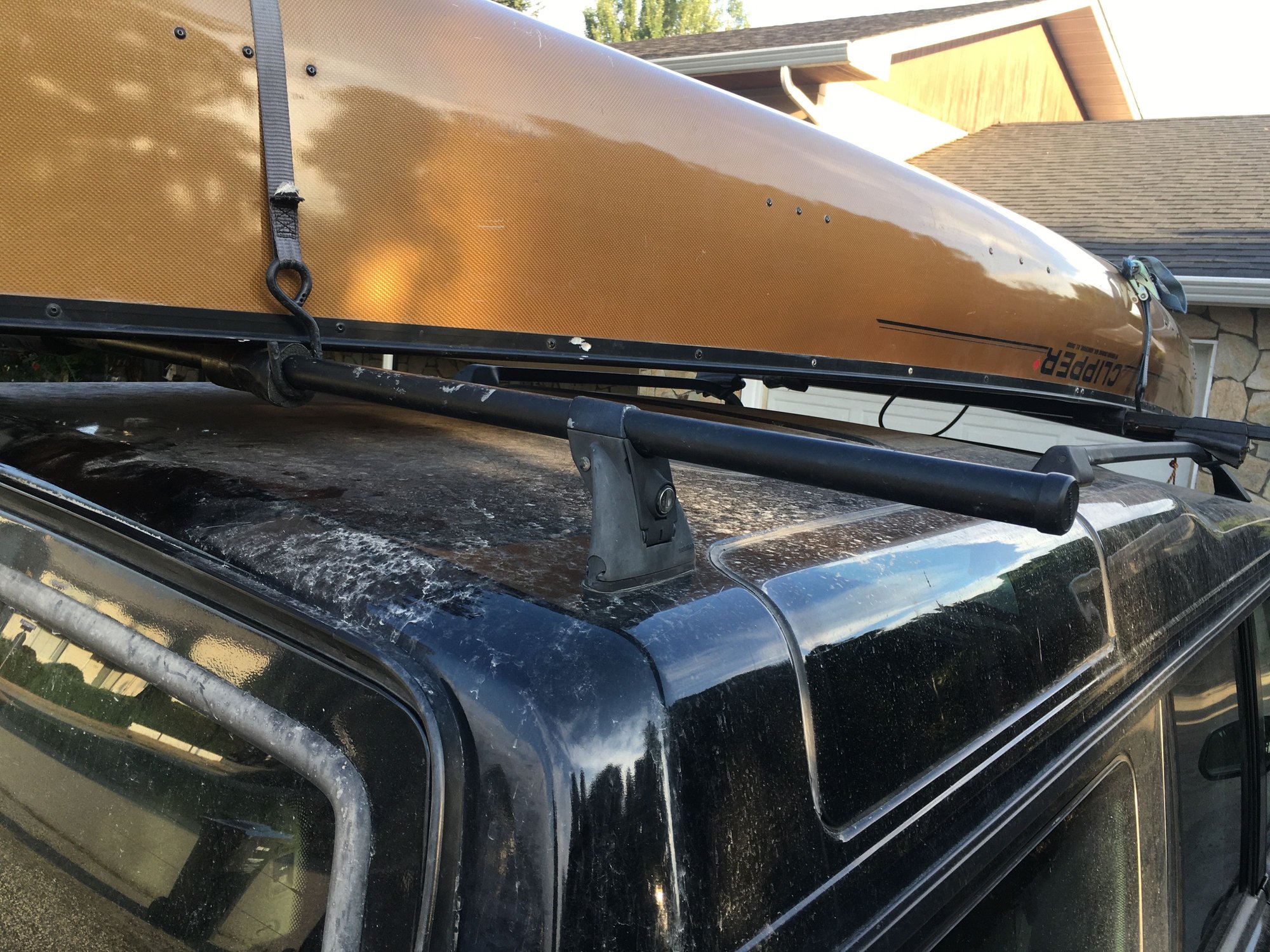

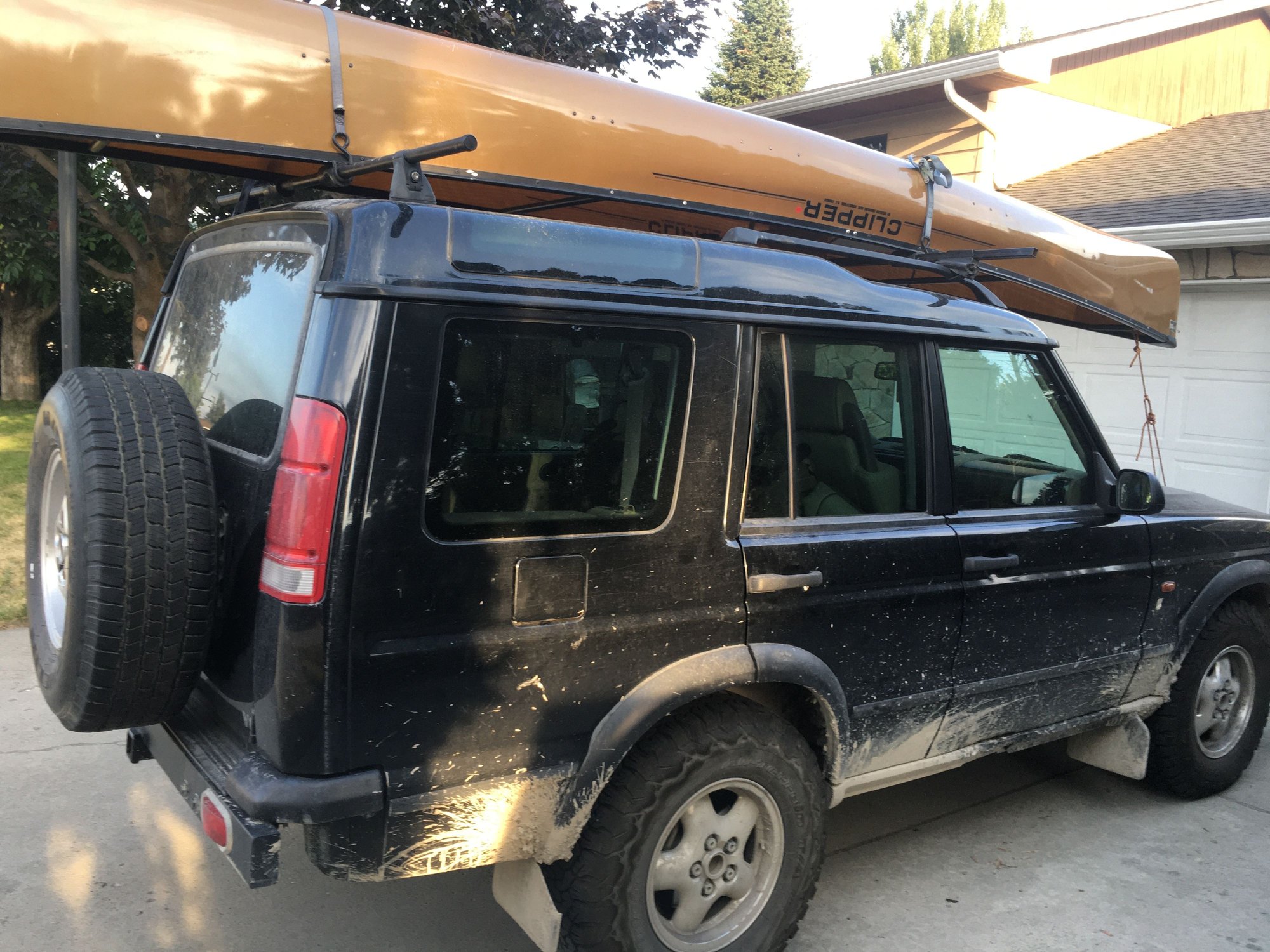

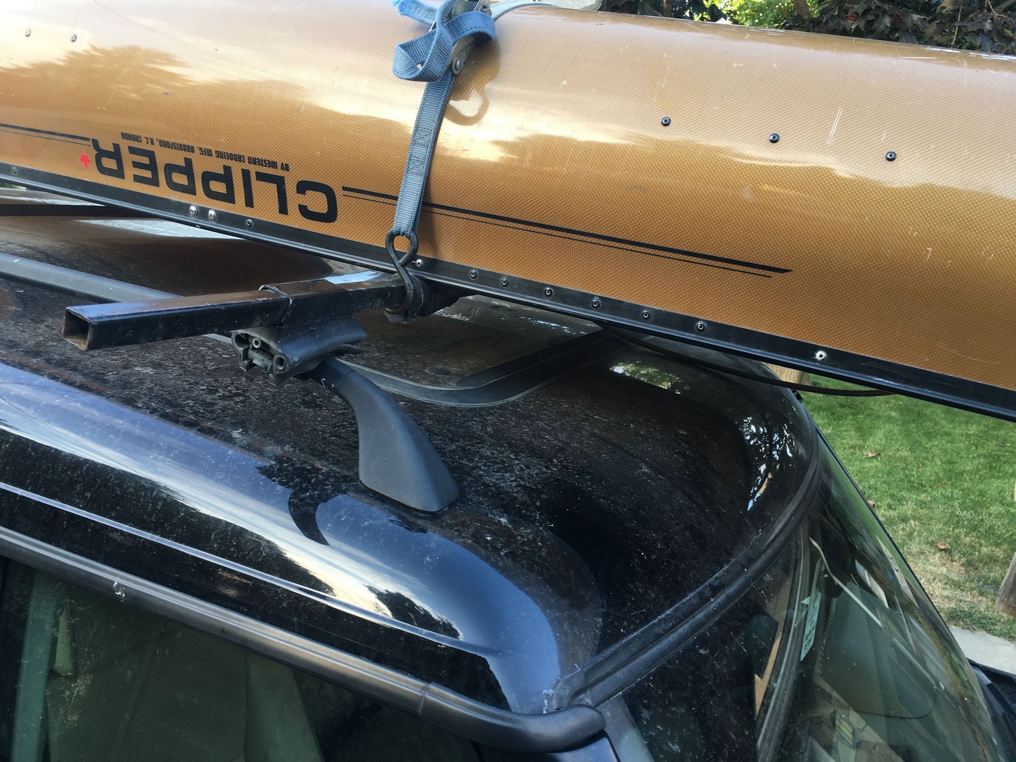

I have a Yakima bar at the back. I lowered the headliner a bit which exposed the existing reinforced areas designed by LR for a rack. I used a cheap crossbar at the front. I’m really happy with the rear rack and the front one does the job.
