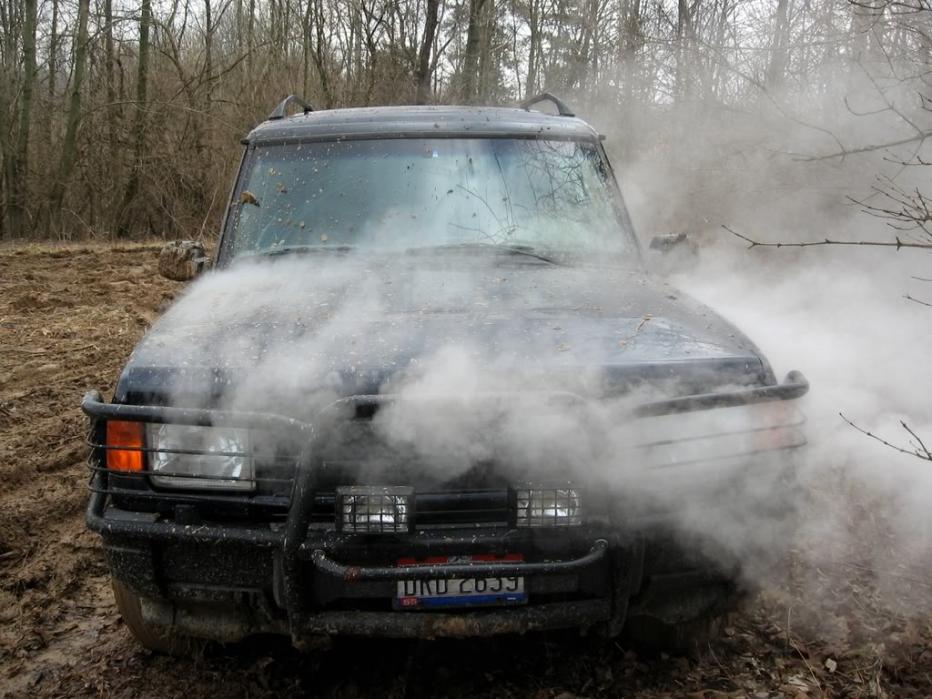

I may be stupid, but I believe the engine is happy with a constant temperature, not 30 degree swings, and that under 200 is good. The oil is happy 180 ish and above, but when really hot it will thin out. The oem D2 stat is rated to start to open at 179 and fully open at 205. But that might be in a teapot. With the plumbing between the block and the thermostat, some difference of 5 -10 degrees is going to be built in. So having the Rover lower temp stat will bring you back to a more reasonable spot. If you look at the stat for the older Rovers, the manual shows testing it for operation, 82C, which is darn close to 180F, wide open. All the emissions control madness has forced engineers to run things hotter to get that last little 1/4 of a percent of performance to satisfy the "law of the land." I would point out that few law makers turn a wrench.
If you take a D2, with Dexmud in a good percentage of the radiator, and add some clog to a few of the metering holes in the thermsotat, it is no wonder things are warmer than you would like. But Rover "hides" that with the temp gauge computations by the ECU. So the unsuspecting owner thinks all is well until ... (pix for general idea)
