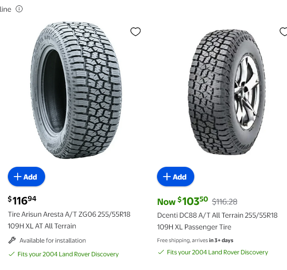

Im in need of new tires since the ones on it right now are old and dry rotting. I spend the majority of my time driving on the pavement, but since its a land rover I need to take it off road occasionally. Usually in the summer, I take it on dirt (sometimes a little muddy) roads to get to lakes, and in the winter sometimes it snows. I don't want to spend more than $600.
I'm thinking about getting these since I found it on sale.
Walmart also apparently sells tires. I found these, but they don't have the parallel groves which I assume are good for preventing hydroplaning when driving on wet pavement. Does the design make pavement driving worse? Are there other good places to get tires from? Are used tires a bad idea?

I see that they are all A/Ts but the Yokohama tire looks to be much more highway oriented and probably a lot quieter but I haven't got any experience with any of them.

The Yokohama's look good, I have also had good luck with Cooper AT's and sometimes WM or Discount Tire has good prices on those, might want to check those out for your application.

Are these snow rated? From my little knowledge I have of tires, you want to expel water in rain, but keep the snow in the treads in the snow (snow sticks to snow better than snow and rubber).
