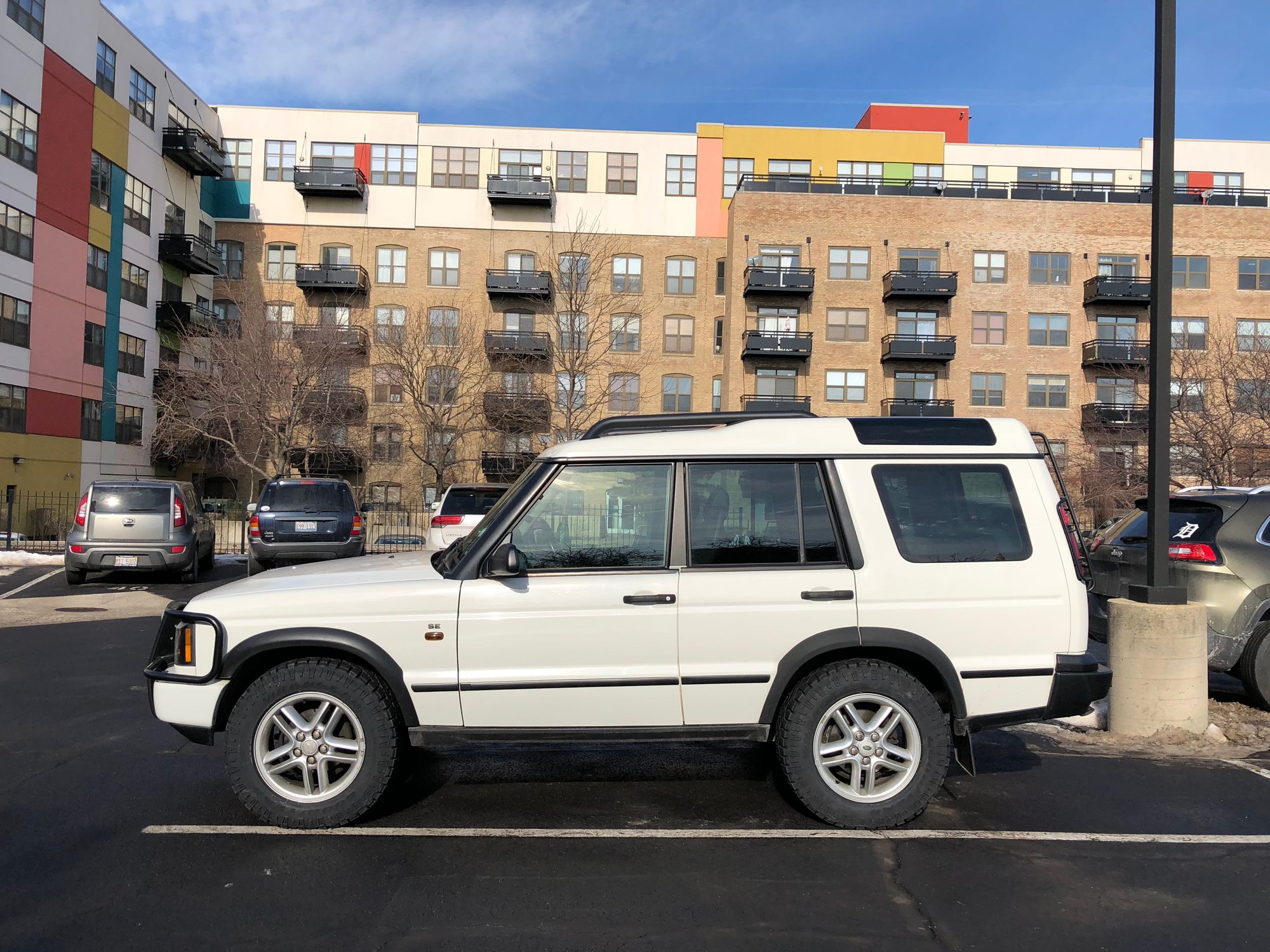

Glad I came across this thread as I have the same question for my 2004 Disco II and would love to hear more thoughts on tire size changes on stock suspension while not having to do any trimming (measurements according to tiresize.com):
Current:
255/55/18: 29.0" x 10.0"
Possible:
265/65/18: 31.6" x 10.4" (I've seen people say they have rubbing and some say they don't)
265/60/18: 30.5" x 10.4"
255/65/18: 31.1" x 10.0" (is there one that is 31" and a little wider that will fit?)
Thanks in advance!

In case anyone comes across this thread; here's how this turned out:
I ended up getting the 265/60/18 (30.5" x 10.4") Goodyear*Wrangler DuraTrac. There is only a very slight rub on full lock to the right.
Here's what they look like:
