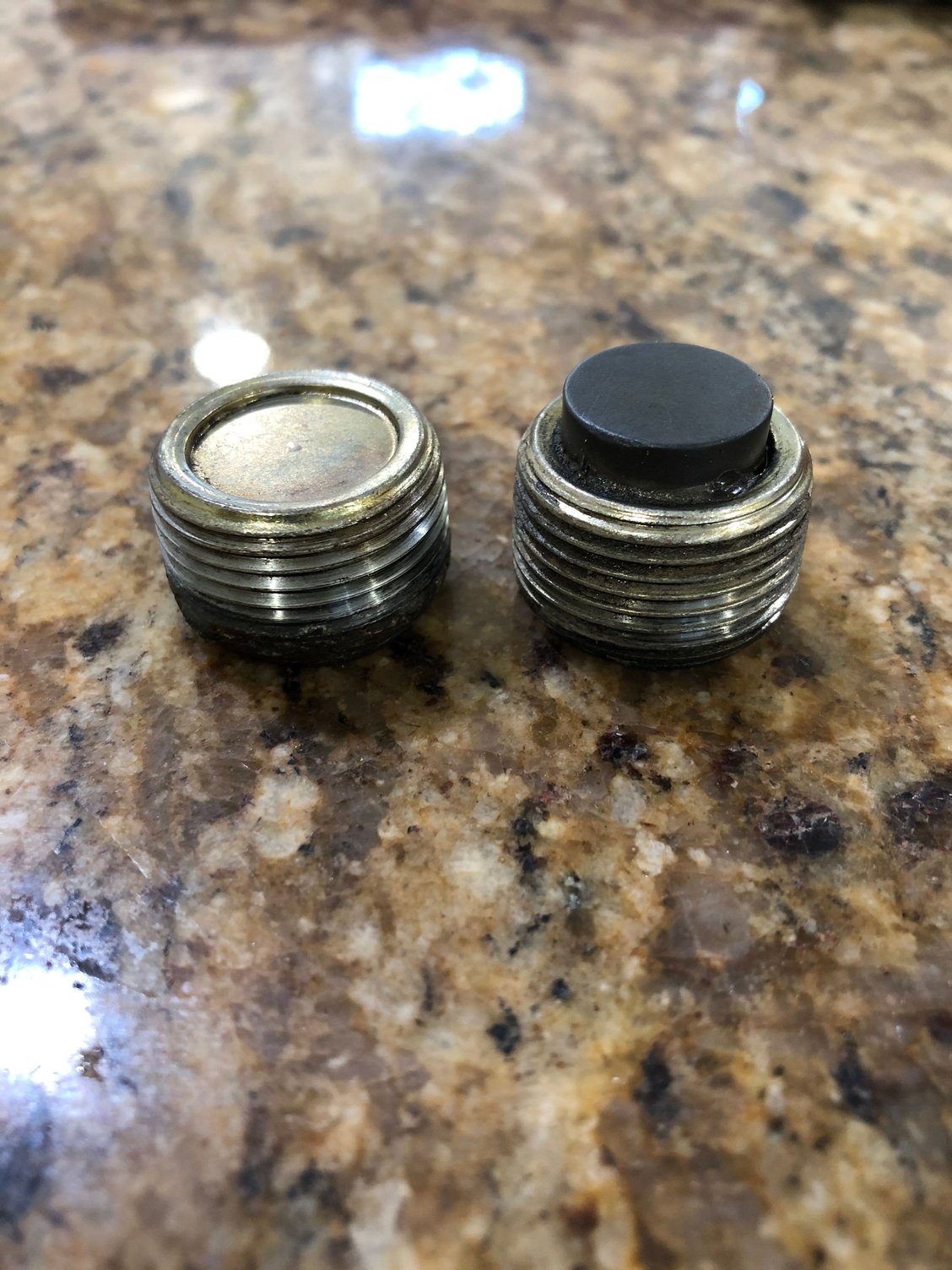

I know how to get the fill drain plugs off using a serpentine belt tool but has any one swapped them for a low profile hex head plug instead? This way a regular combination wrench can be used.

You can but need wobble extensions or adapters. For the fill plug I used a 1/2 - 3/8 drive adapter with a 4” extension. The drain is more difficult with the crossmember in the way. Both plugs are pretty rough and a little rounded off. If I can replace them with a hex head plugs instead of 1/2 drive plugs just makes servicing easier next time.

For future reference the drain/fill plugs are both 26M x 1.75 thread and 16mm long. Drain plug just has a magnet attached on the back.
