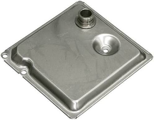

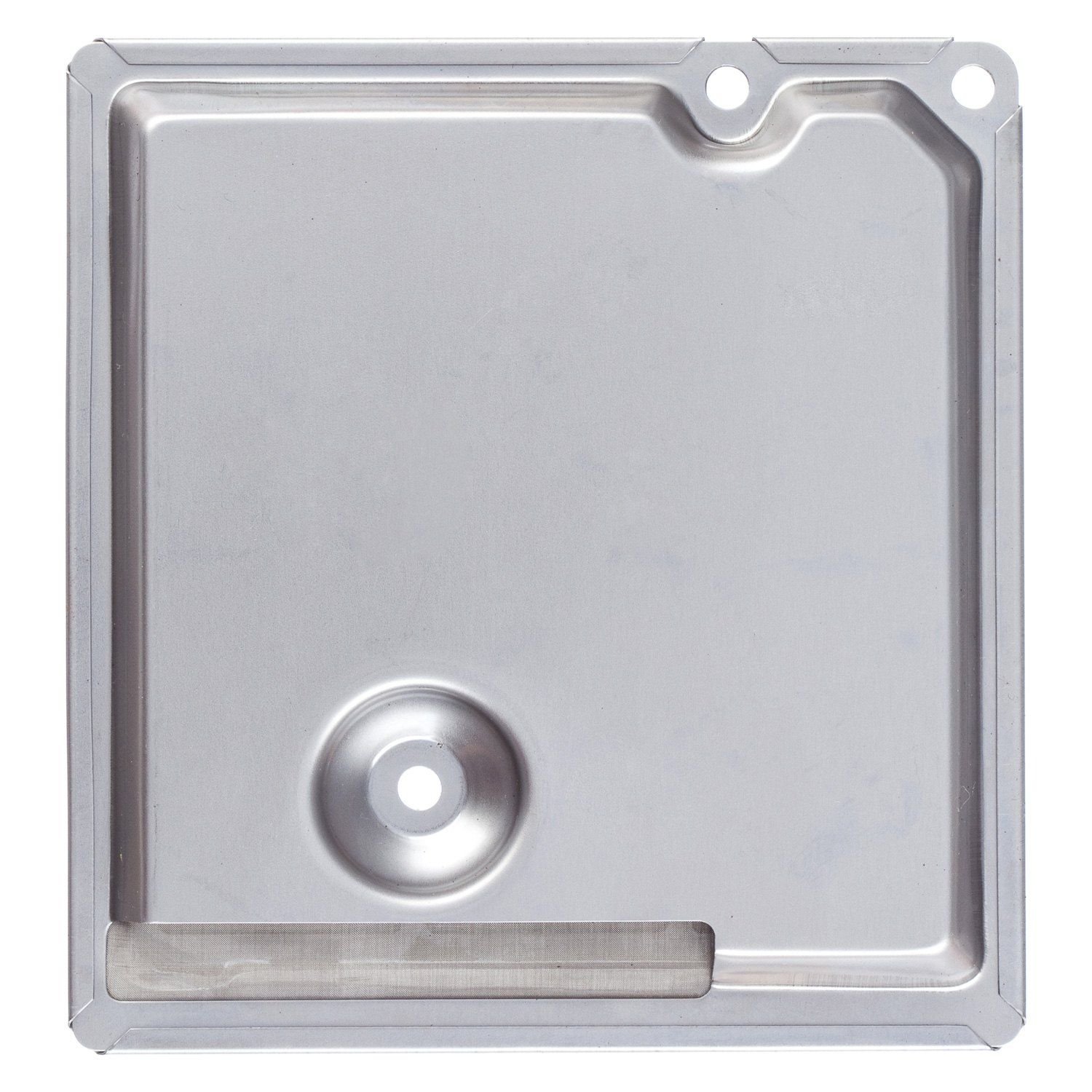

I recently needed to replace my transmission oil pan gasket and the kit in town comes with both a filter and a gasket so I figured why not do them both. When I went to install the new filter I found that there is nowhere to place the pickup tube. Thinking this was a fluke, I checked the box and it reads "2000 Discovery II no pickup tube." And when I check RockAuto I see that the 'Premium' filter offered is also tubeless by design.
Will this filter work? Do I need to drain the pain and do this job again with a different filter?
This:
Vs this:

IDK maybe I'm losing my mind (it's possible) but I've never seen a ZF AutoBox Filter ( # RTC4653 ) NOT
need a pickup/suction tube ( # TQW100030 ).
Remember to change the Pickup Tube O ring ( # RTC5818 ).
FWIW, I would NOT use RockAuto as a reliable source for LR part numbers.

Is that a picture of the normal filter just upside down???

Edit: Best4x4 no, those are the same faces. Instead of the spout for the pickup tube, the edge has an opening where theoretically transmission fluid would be drawn in. The bolt holes line up perfectly, the whole thing is odd. Another forum mentioned that a 3.2L Land Rover had a shallow pan but I can't find anything about that elsewhere. Did a 3.2L exist?

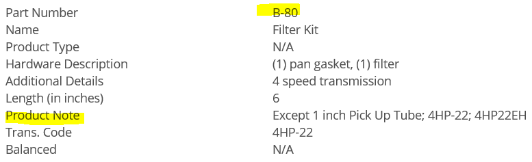

That pic looks like the ATP B80 and even according to their website is the wrong application.
> ATP Automotive B-80 Filter Kit
Not double checking when I call parts in locally is where I keep failing! AutoZone strikes again
It looks like they sold you a TF 152 so...…. IF you are going back to AUTOZONE get a correct # TF 638

I just went out and checked the box and receipt. You are absolutely correct on what I was sold. I'll probably go with OReilly Auto this time but I'll be double checking. Sad I have to do this all again, glad I didn't drive it like this. Perfect time for me to get this all done seeing as I'm not going anywhere until my engine mounts come in. The engine is dropped a couple inches currently but that's for another thread perhaps, hehe
