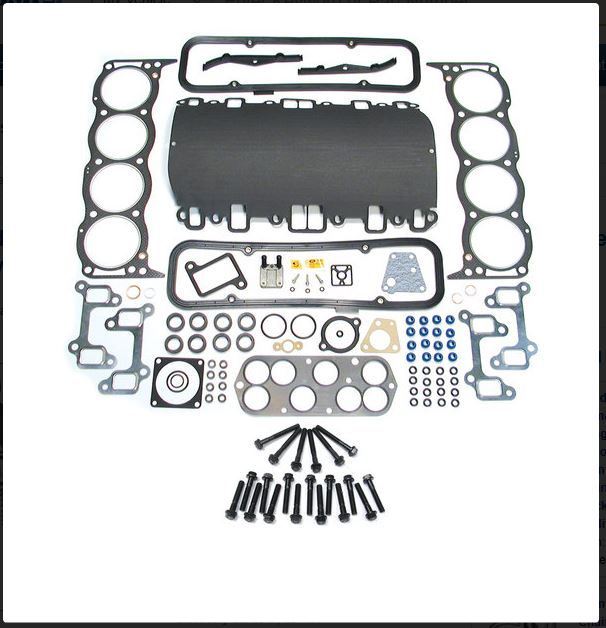

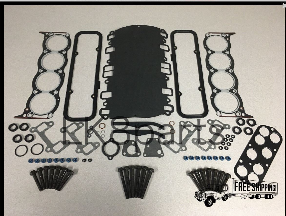

1. What is the difference between the Lucky8 and AB head gasket kits (beside AB having more bits and pieces), is the material the same?

Composite or generic hg's? - both ab and lucky8 say composite

As far as the kits, some of the gaskets are included and some left out, depending on kit style and vendor. Some of the exhaust gaskets are different. But the HG's all look the same (except for the little copper washers). I have used VReintz comp head gaskets on many rebuilds in the past. The VReintz HG image is the same as Elring composite image which is included in the AB comp kit, and same as the Amazon and ebay head gasket kit. Suspect one comp HG factory(probably in China), many wrappers......and the 6$ rimmer bro HG's look the same but without the x2 little copper seals....
Also, I suspect that the composite material (depending on batch?) breaks down with heat cycling (thermal and mechanical) sometimes sooner than later. OEM gasket is Supersession(s): ERR5437; ERR7217
Look closely at the gasket composition. I think the ridged metal AB gaskets for exhaust headers are better. Don;t know what the valve guide seals are made from, but I have the light blue ones from the AB kit on my heads (viton?) They have nice little retainer spring. I think the rest of the kit components are same manufacture, allowing for what is or is not included.... and of course, you can't tell the quality of the TTY bolts. No idea who makes those....And bosch kit vs gems....make sure you see the gaskets you need. Those rubber O rings are important for H2O pipes....
