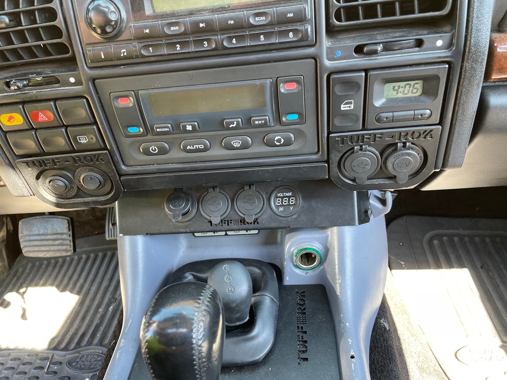

Also bought the USB charger thing that’s supposed to fit near the transfer case shifter, Big surprise - it doesn’t fit. I want to like their products, but it’s hard…
