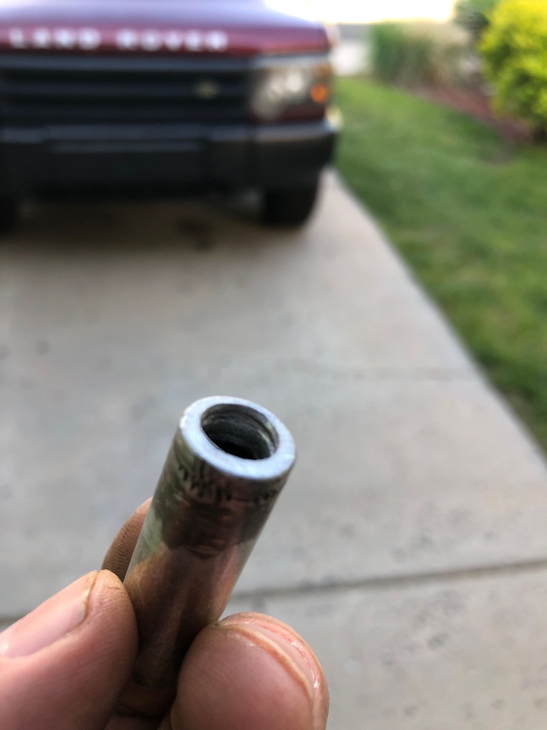

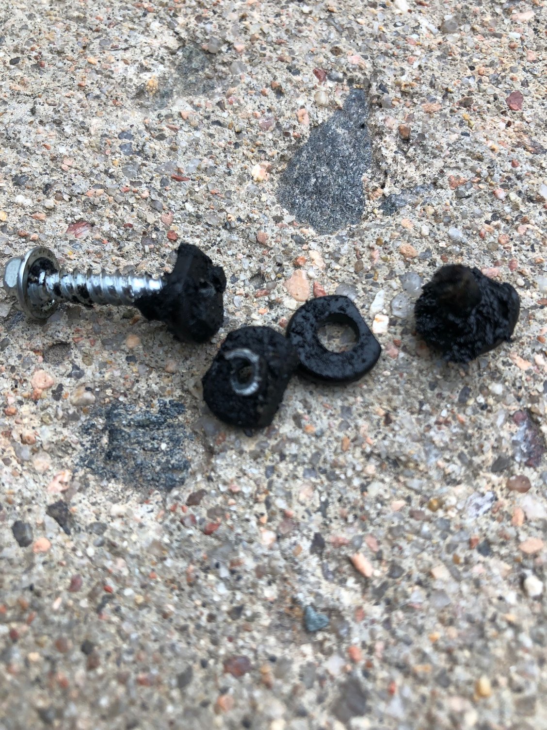

Drilled out
Remains of what used to be the oil separator.

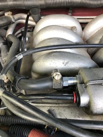

Done... end result.
All out...
Drilled out...
Finished... thank you all for your help!!!!! You all are rockstars.

Stuff out...
Drilled out...
Finished
Oreilly's PCV 308

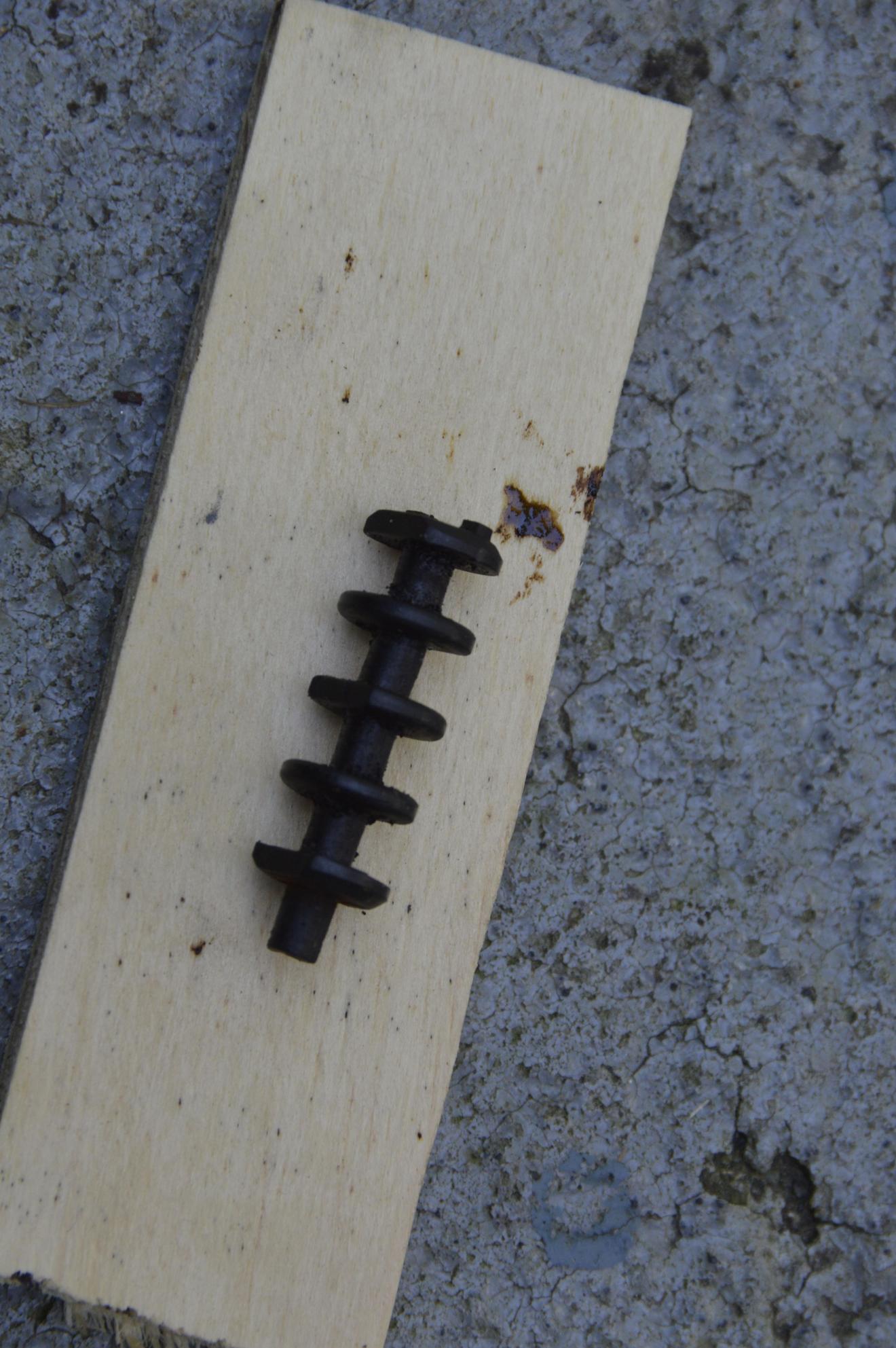

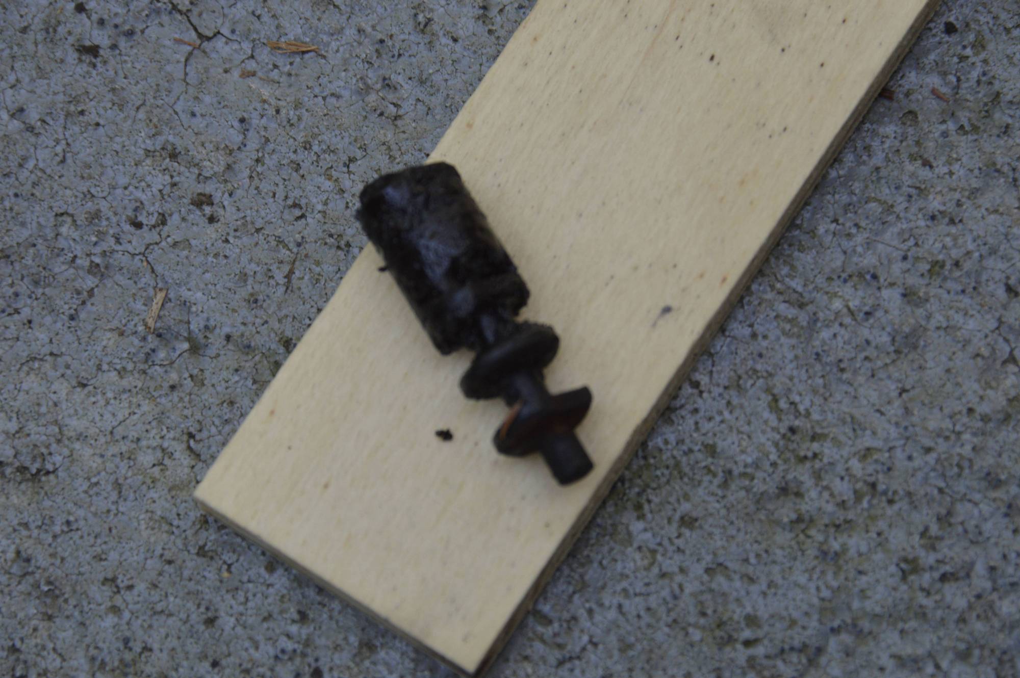

Finally got that little booger out, I bought a set of mini vice grips they worked great. It was completely clogged - literally a few pictures for those who are not sure why this is a good idea.
Crud that came out as I got the the plastic Spiral out
State if the spiral, the solid looking bit is the top
After cleaning
