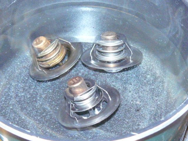

Forgot to mention the analogy of the thermostat and the throttle. Both are a valve, and open from a minimum to a maximum position. But you don't normally spend a lot of time at wide open throttle. The thermostat is not on/off like a light switch, or an old style home thermostat. Pop one in a pan of water (pan approved by SWMBO) and bring it up to a boil. See pix 1. You'll see it slowly opens, and slowly closes, not a snap action. If you are at the low end of the range of temp for the stat, say 180 - 195, it may close as cooler water comes by, then open back up. Once you get to fully open condition for the stat, it can still close, but usually by then (on a warm day) the rest of the cooling system has warmed up, and it won't shut 100%. So the unit can "control" the temperature and keep it (a) above the minimum operating temp - when it first begins to open; and (b) keep it within a narrow range and stable temperature is a good thing for stuff that expands and contracts. Once you reach the point where the stat is 100% open, and staying there, it is like having no stat at all. So IMHO, you want normal operation in the minimum opening temp to fully open temp, which on a D2 is 180 - 204F. Not like in the pix 2.

That picture 2 does show a kind of high temperature, but if you had a picture of the car's temp monitor, it would still be showing dead center normal. So the engineers feel that temperature is perfectly normal for the vehicle, just not optimal when looking at the temps required to start the electric fan, unless that gauge is on a TD5 engine.
