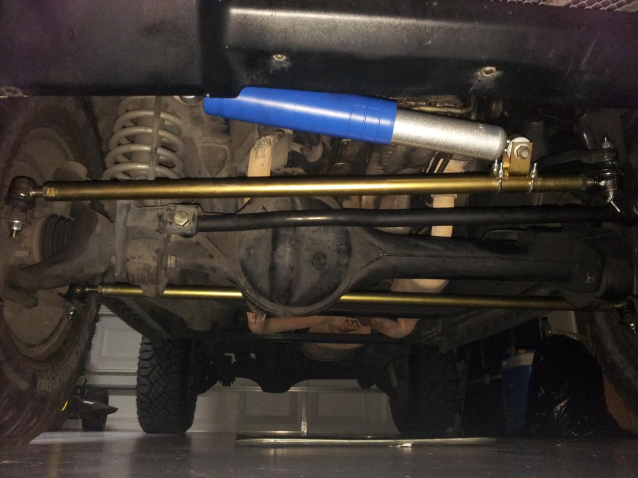

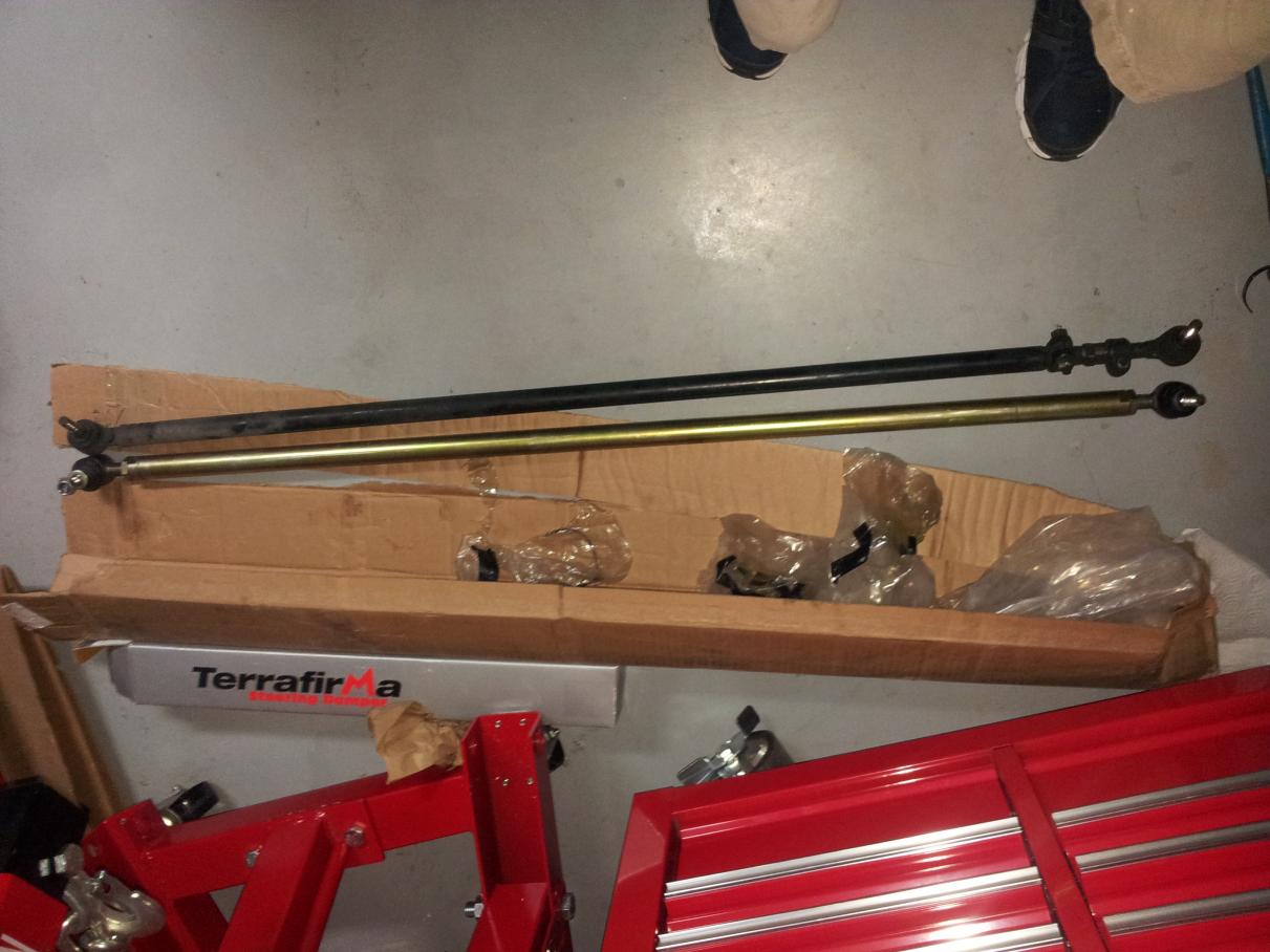

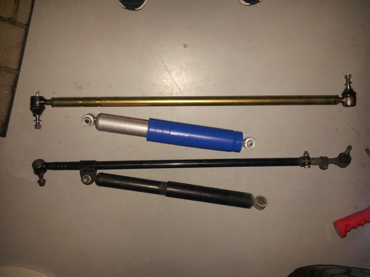

After looking closer I actually on have one tie rod end with a zerk fitting. It is the one that connects to the drop arm. the other 3 that connect to the knuckle do not have them. I'm guessing it was designed that way?

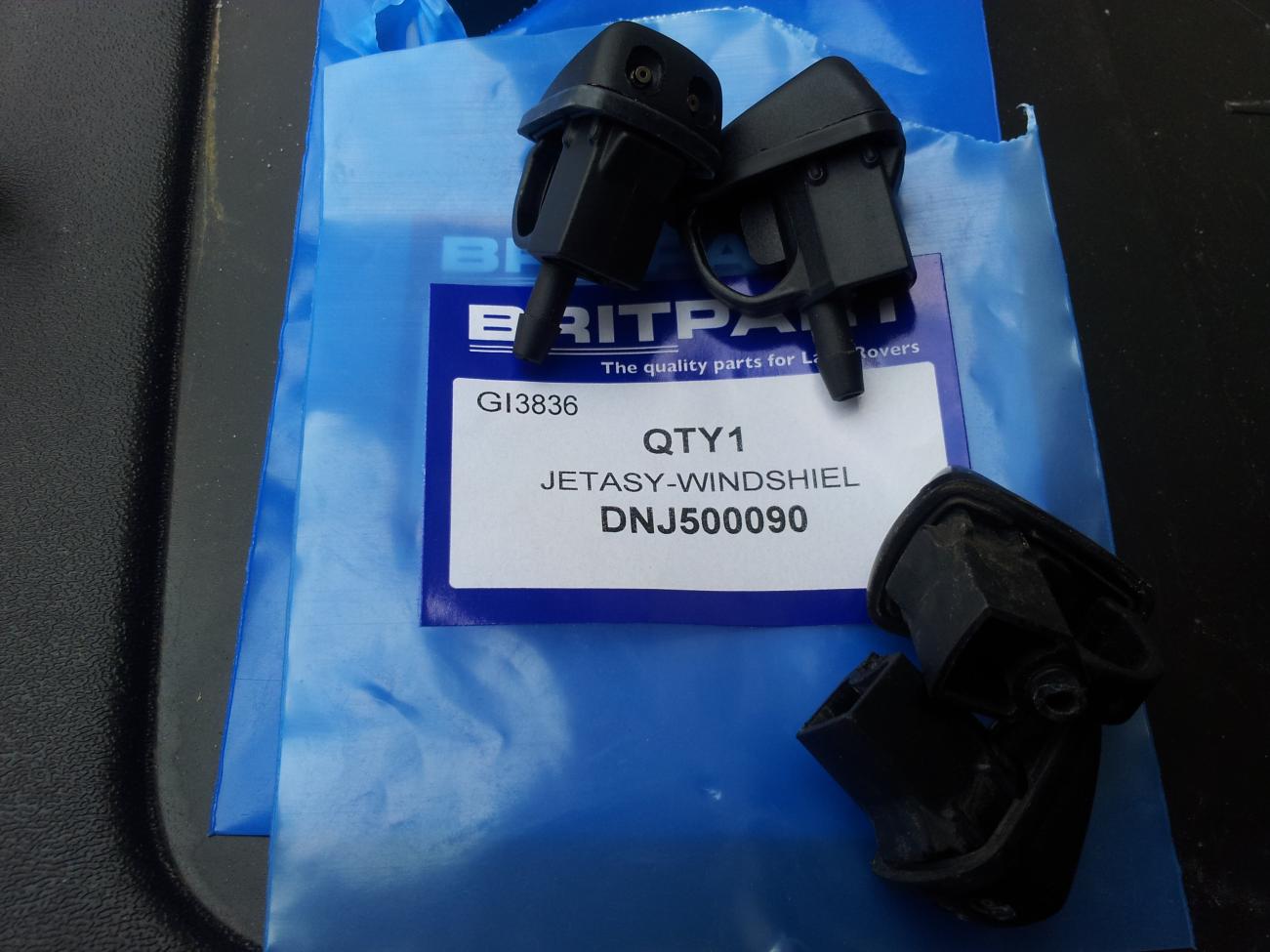

I installed my new HD steering rods and got some new windshield washer jets installed just in time for bug season.

I just received my new windshield jets also. How hard/easy are they to switch out? I need to put mine in.

Might be one of the easiest things you can do on these rigs. Unhook the fluid lines. Pop out the nozzle and replace.

All you do is reach up under the hood where the jets are, and squeeze the 2 clips on the jet and pop it out the top.
