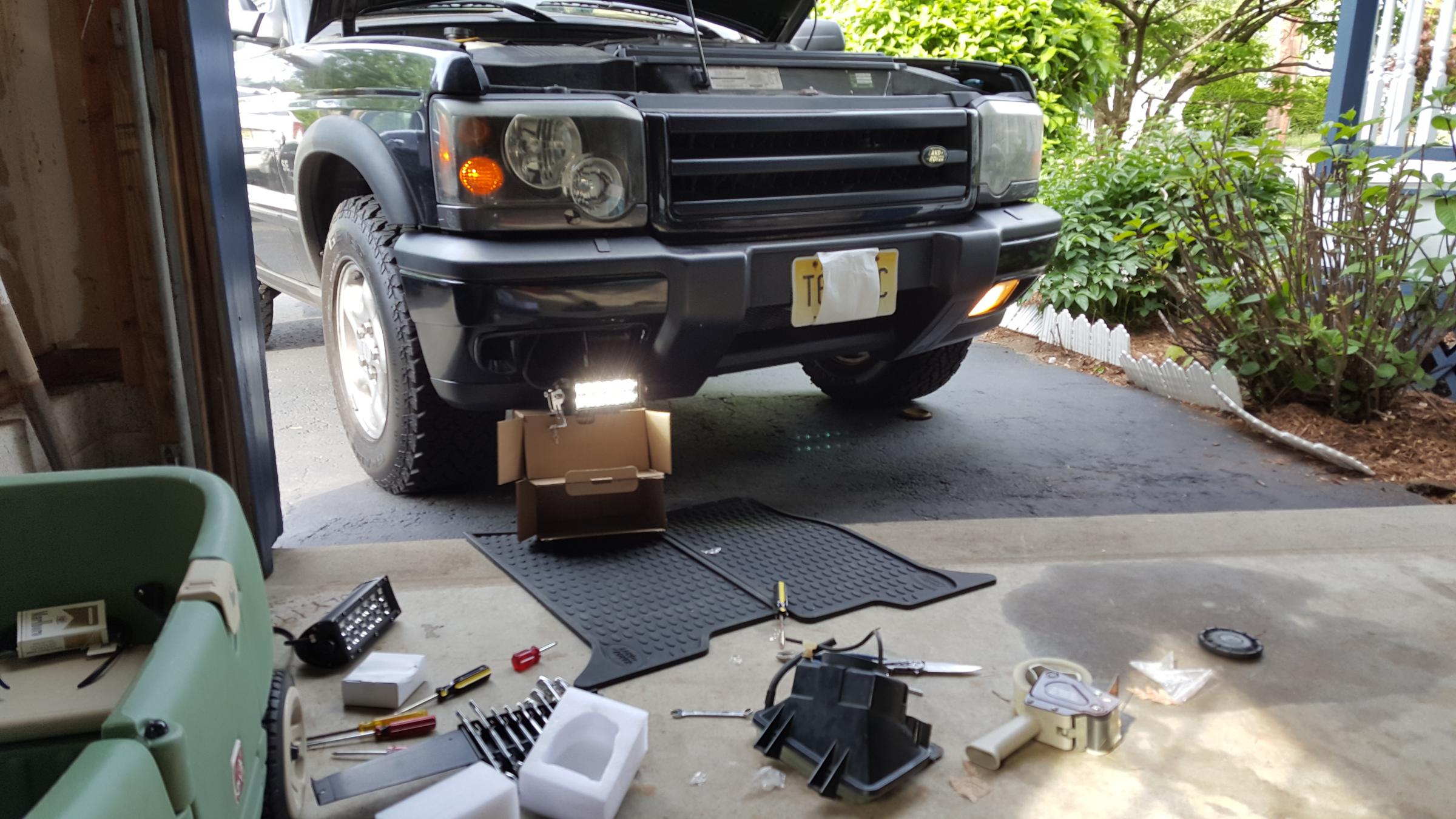

A little testing/proof of concept.
Attached Thumbnails What did you do with your DII today?-20150524_164440.jpg

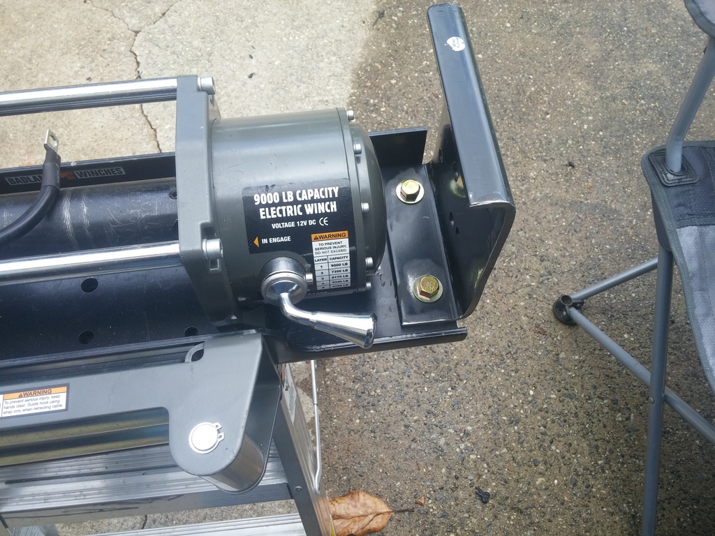

Finished my winch install. I bought a universal winch mount tray from Harbor Freight. It's fairly heavy, 25 lbs. Made from .25" steel. I meaursed from the middle 23.5" to mount the winch. The ends I cut off I used for my brakets to mount to the frame. I replaced the bolts with 7/16" x 5" grade 8 bolts and locking nuts. Had to team the holes just a little to make them fit. In the tray I made two slotted holes per side so I could have a small amount of adjustment if needed. Fastened the bracket to the tray with four grade 8 bolts 3/8" x 1" again with lock nuts.
[IMG][/IMG]
