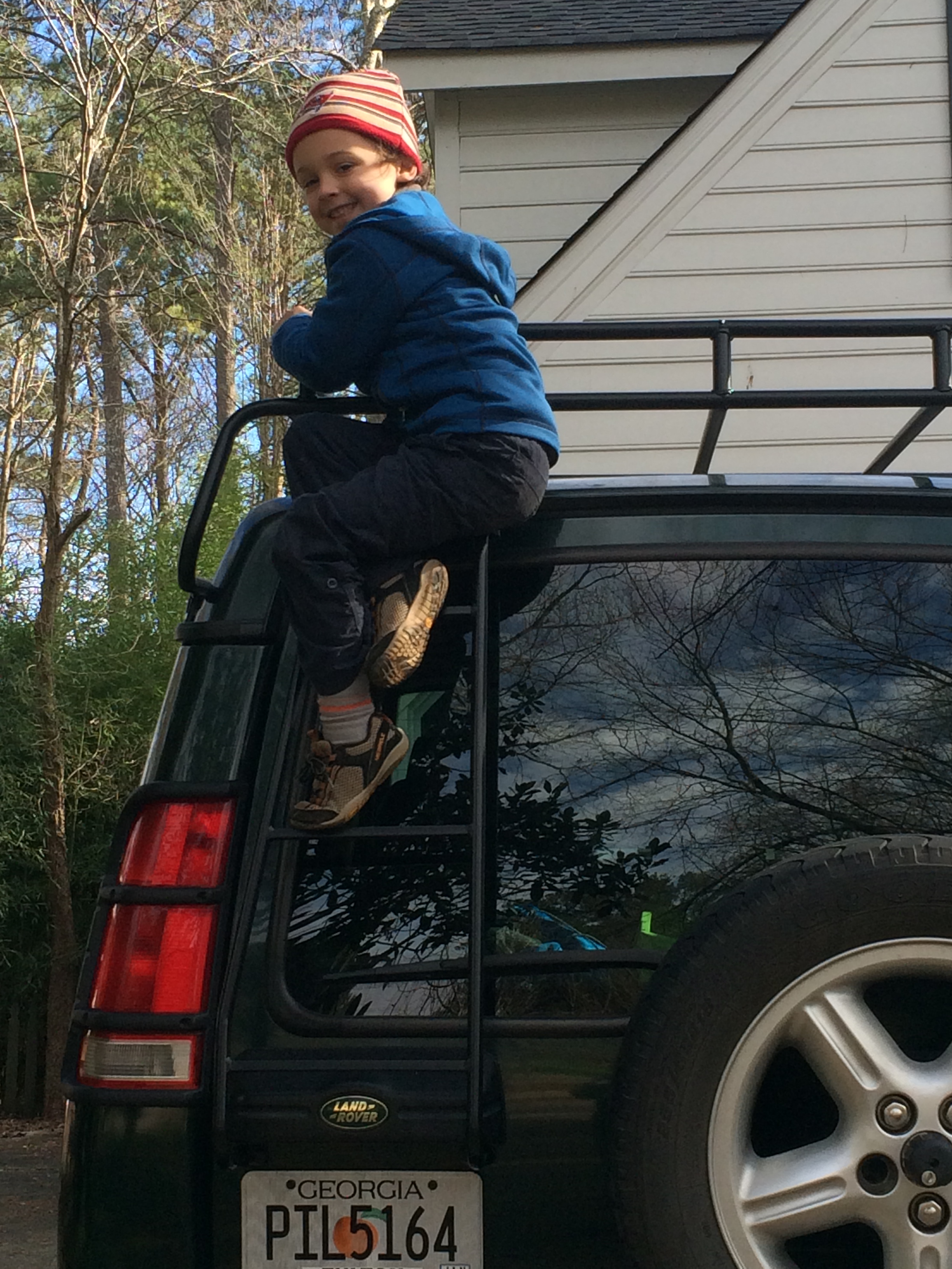

Installed my roof rack ladder... Finally. My 5 year old likes it!
First time working with a threaded rivnut installer/gun. Bought a cheap one at HF and it worked perfectly. I added some rubber washers to help keep the water out. I know some just use sheet metal screws and call it a day, but I like following directions... well... most of the time.
