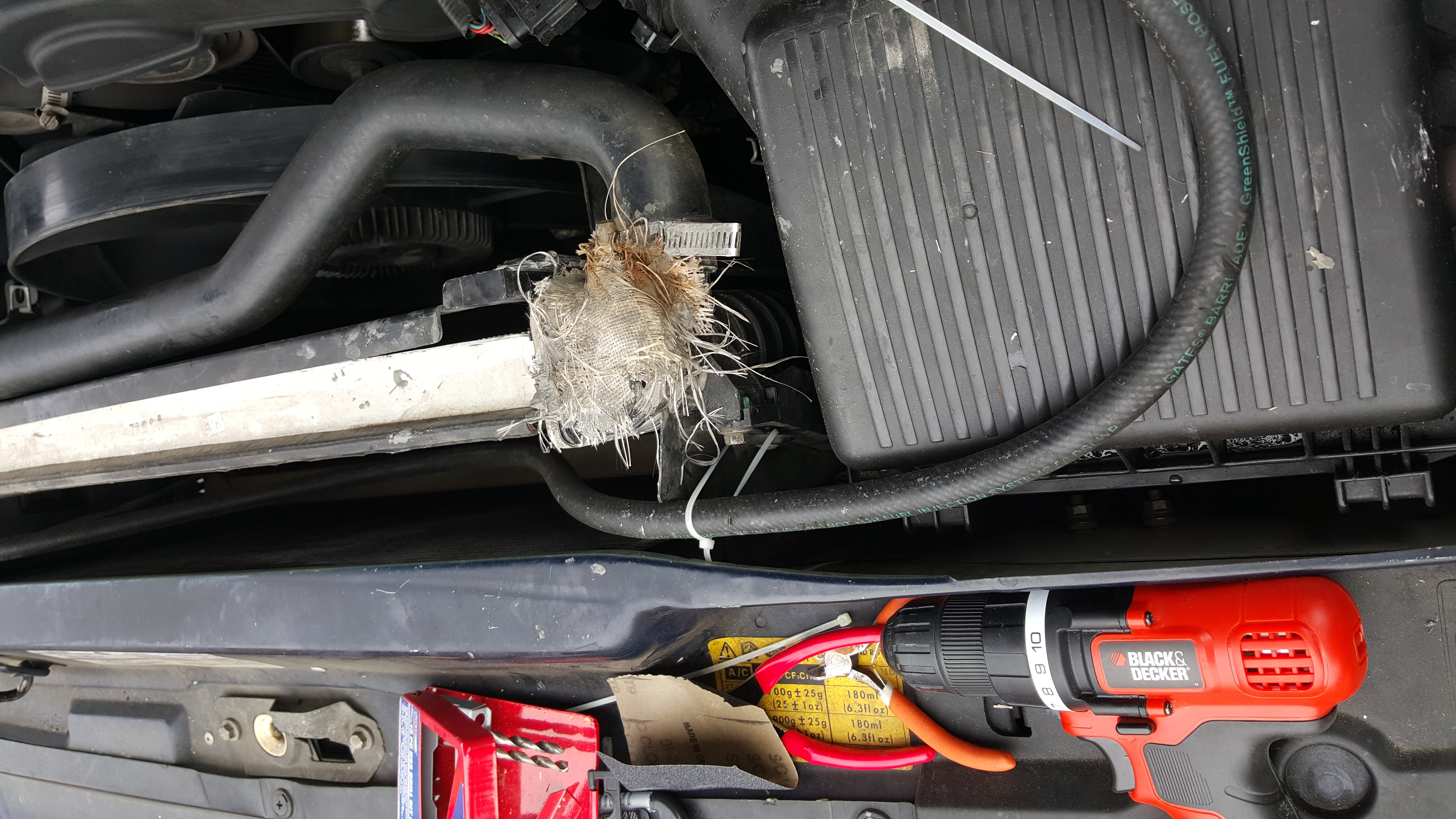

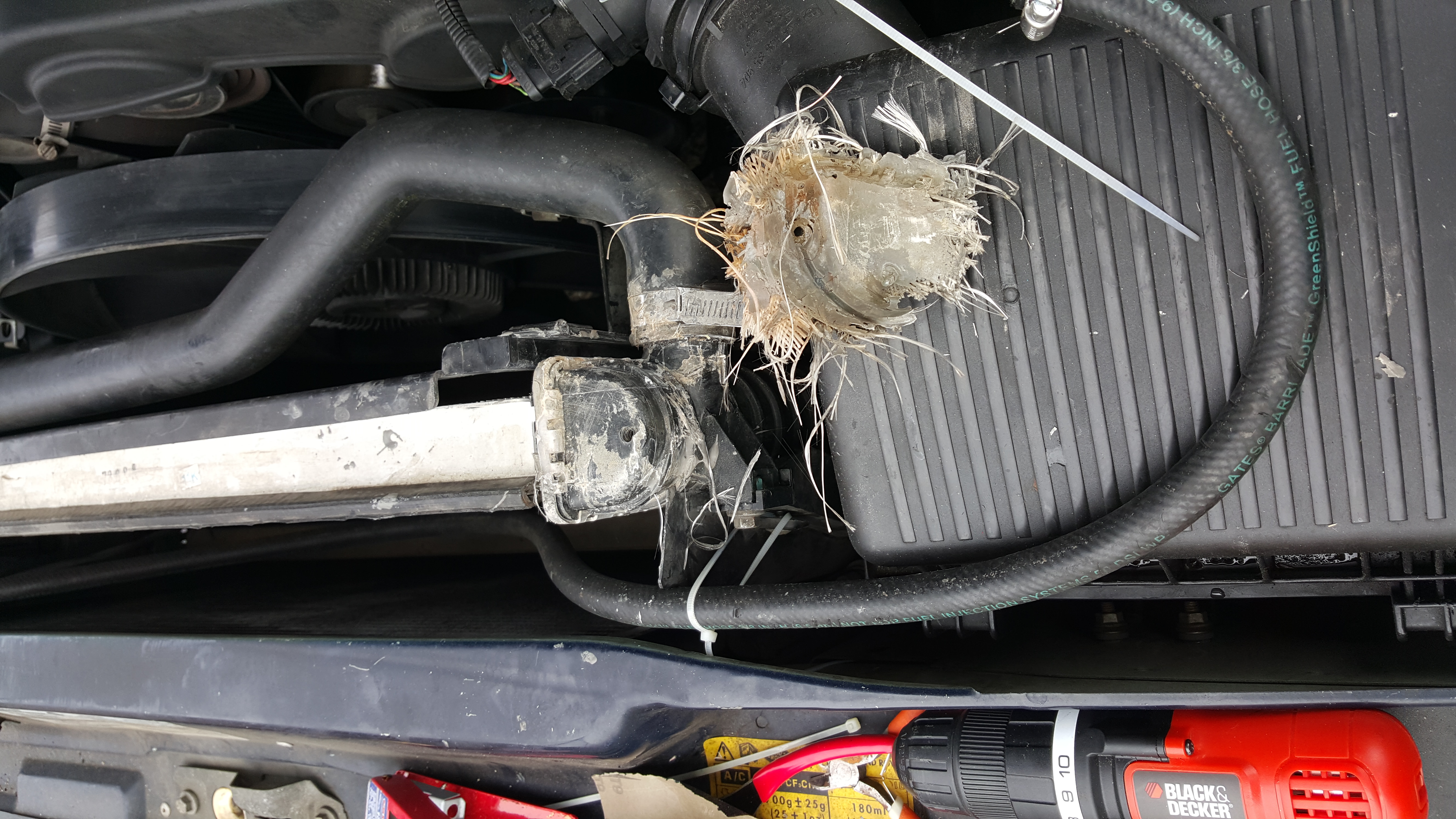

My Turkish redneck repair failed yesterday (it lasted for about 6 months, survived a crazy texas summer but failed in winter). But would I buy a new radiator for $150? Noup. So I drilled the little hole to enlarge it, I will put a hard plastic pipe into it and seal around it. Pics coming soon hahahah

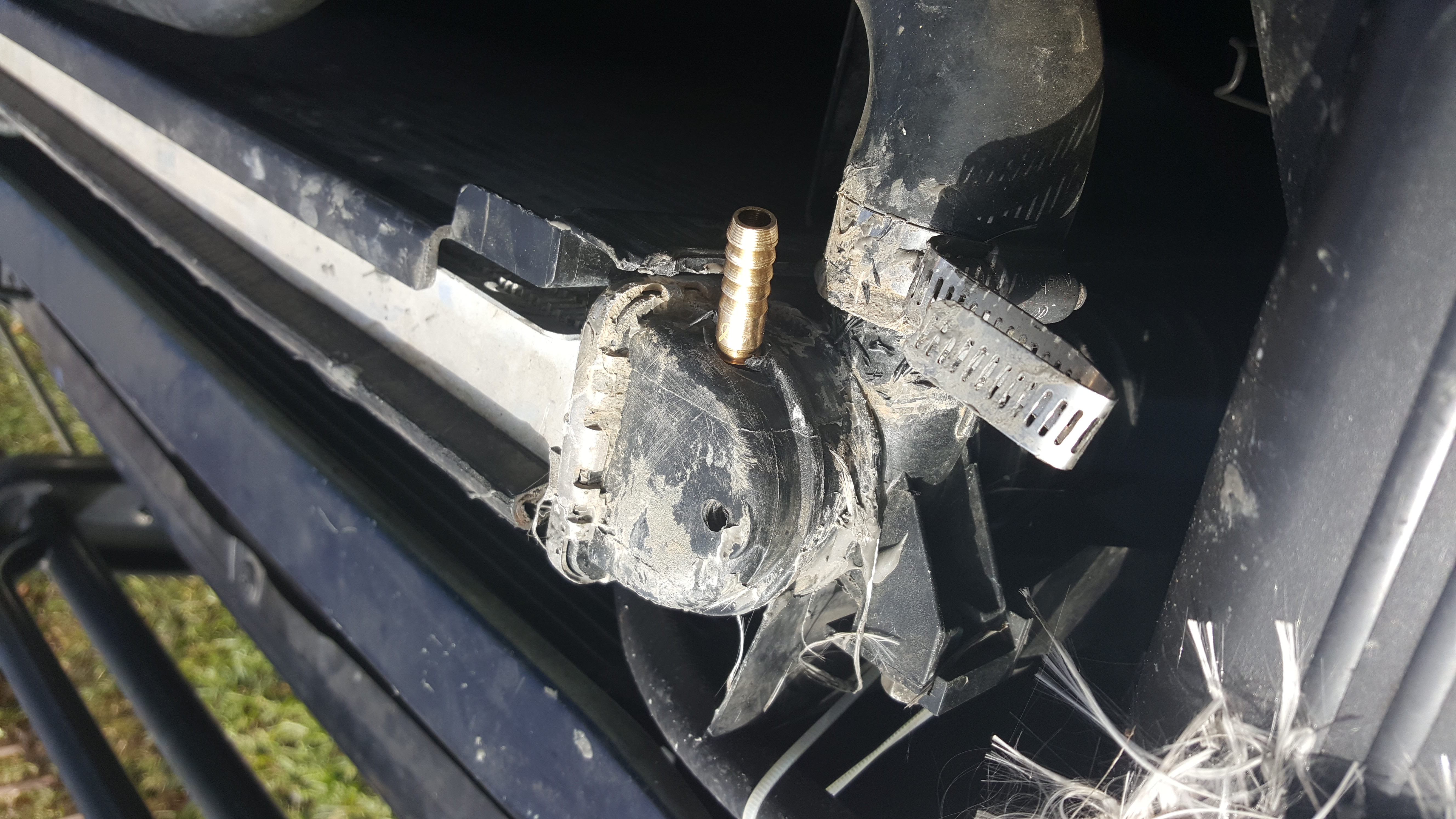

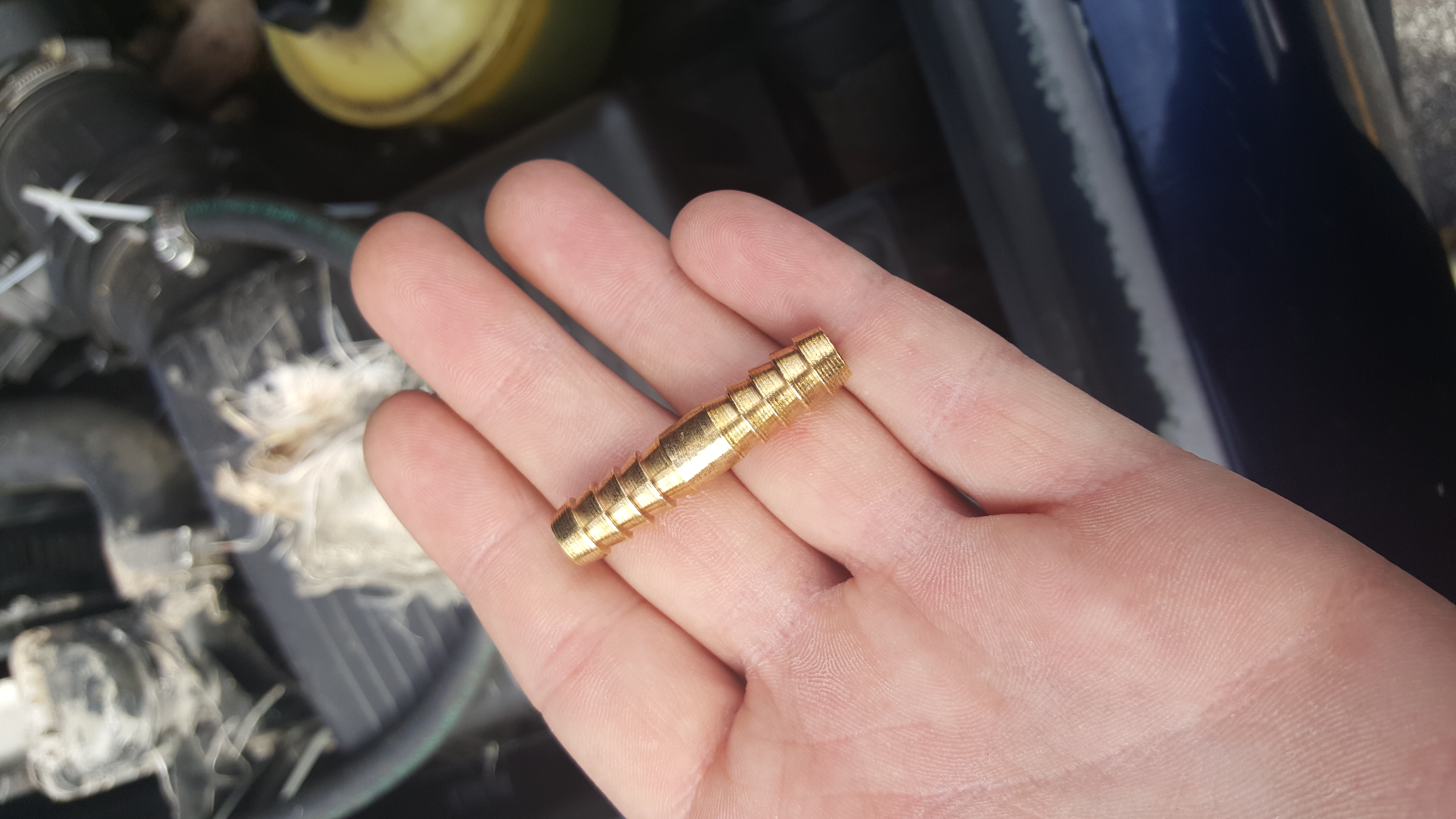

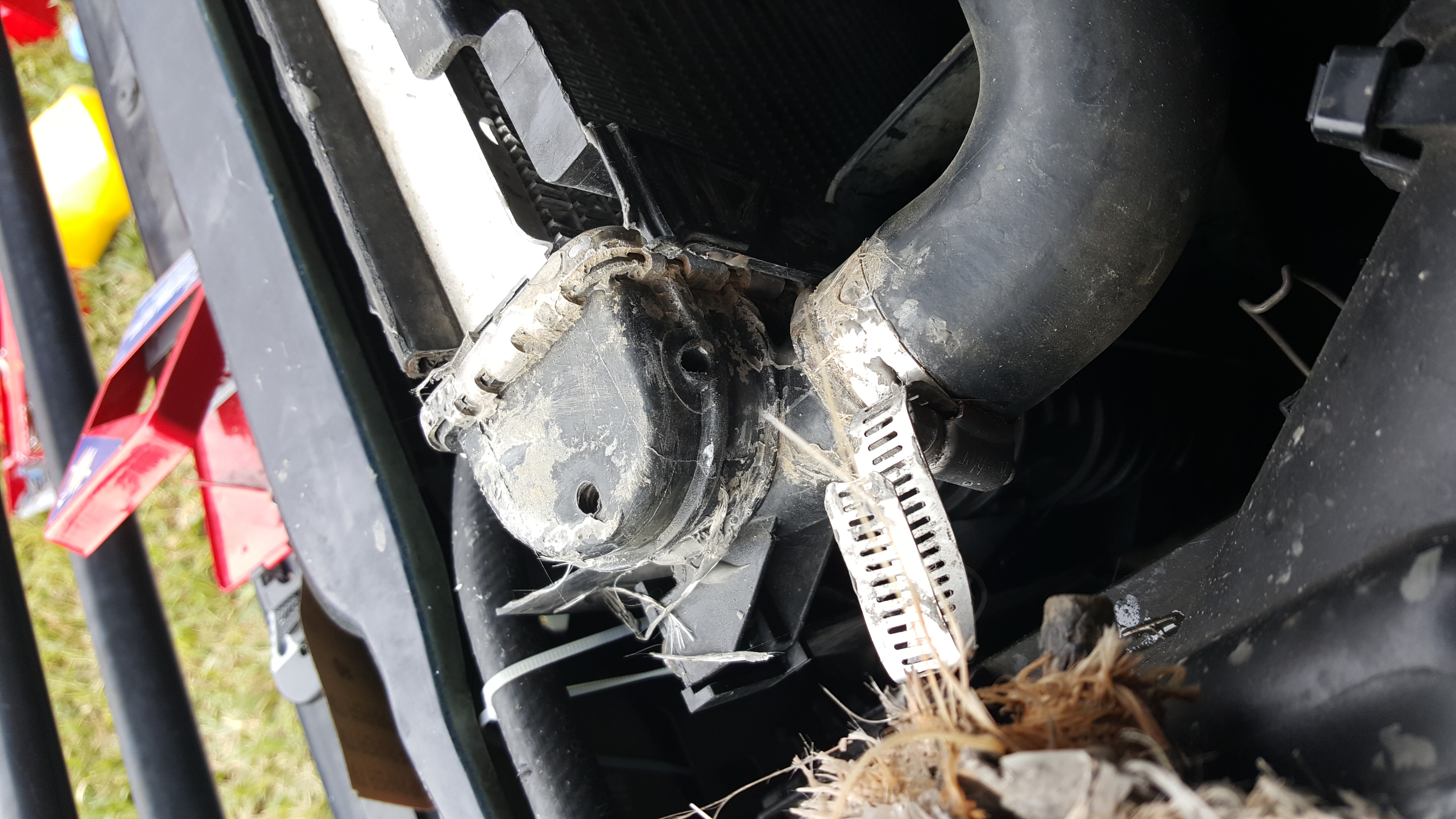

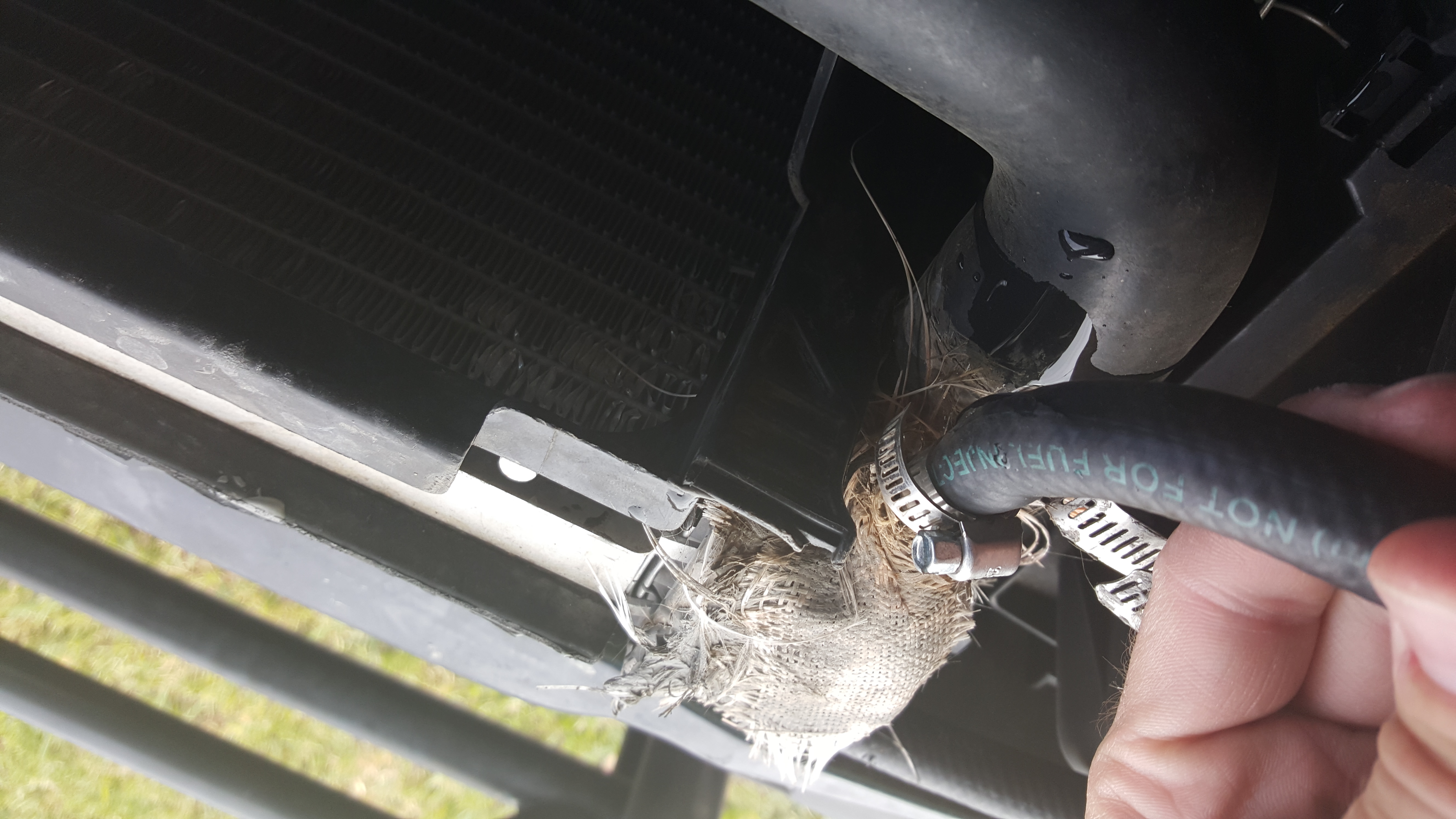

so I found this thingy at Lowes, sanded it, i made the hole bigger, put about an inch of it into the hole, and sealed it with 'quick steel'. Waited an hour, filled up the system and drove it for few minutes...so far so good. 3$ repair
