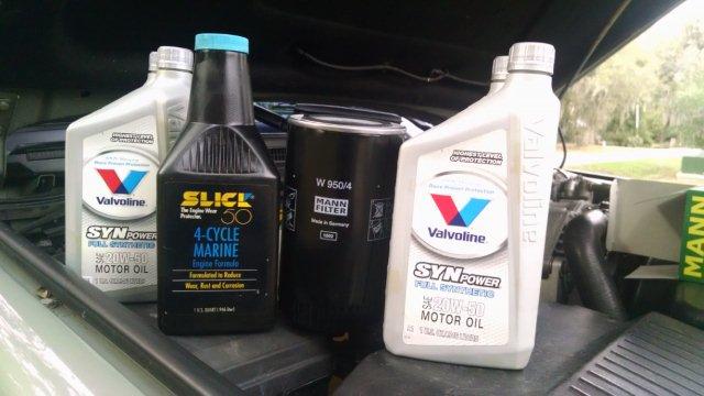

Default Seven+ Quart Oil Change
First change since purchase in mid November and 1,200+ of my miles. Prior to drain added Sea Foam to oil and drove per their recommendations. Used what was available in my lube cabinet for refill plus newly acquired filter. Snake oil was just there and thought why not, obviously don't expect any benefits and will monitor for possible adversities.
Followed procedure in manual waiting to renew filter until after crankcase drained/refilled and partially filling manly filter with nearly a full qt of oil. Upon start up oil light extinguished within a second or two. Leak check good after several minutes of run time and topped off oil to full mark.
The awe of a quiet engine after changing the oil is a wonderful thing.
