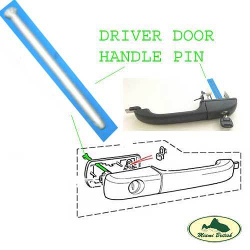

Removed the drivers side door panel and the outside door handle to get to the broken pin that plagues the disco2. I got the pin out and put the door back together while I figure out what I want to do. Deciding whether to attempt to make one from a nail, buy one from MiamiBritish for 29.00 or get the one from Falconwerks for 85.00. I am leaning towards making my own, but using stainless rod instead of nail, and trying to duplicate the Falconwerks one. Cant hurt to try anyway.

update on door lock pin.
I went to Home Depot and purchased 2 40d nails at .15 each, bought a new 7/64 drill bit and a new set of dremel cutting tool set(did not need, had plenty). measured where the hole should be, drilled it with a hand drill(PITA, but managed). used the dremel to shape the cross at the end. Pulled the door handle, secured the pin, and reinstalled.Works like a champ. I would have loved to have the falconwerks pin, but 3.00 instead of 85.00 was a no-brainer.

+ the original lasted 15 or so years, stainless would out last the truck

I looked at stainless options but I think the nail will last along time, since I never use the key for entry or locking anyway. I just like everything to work.

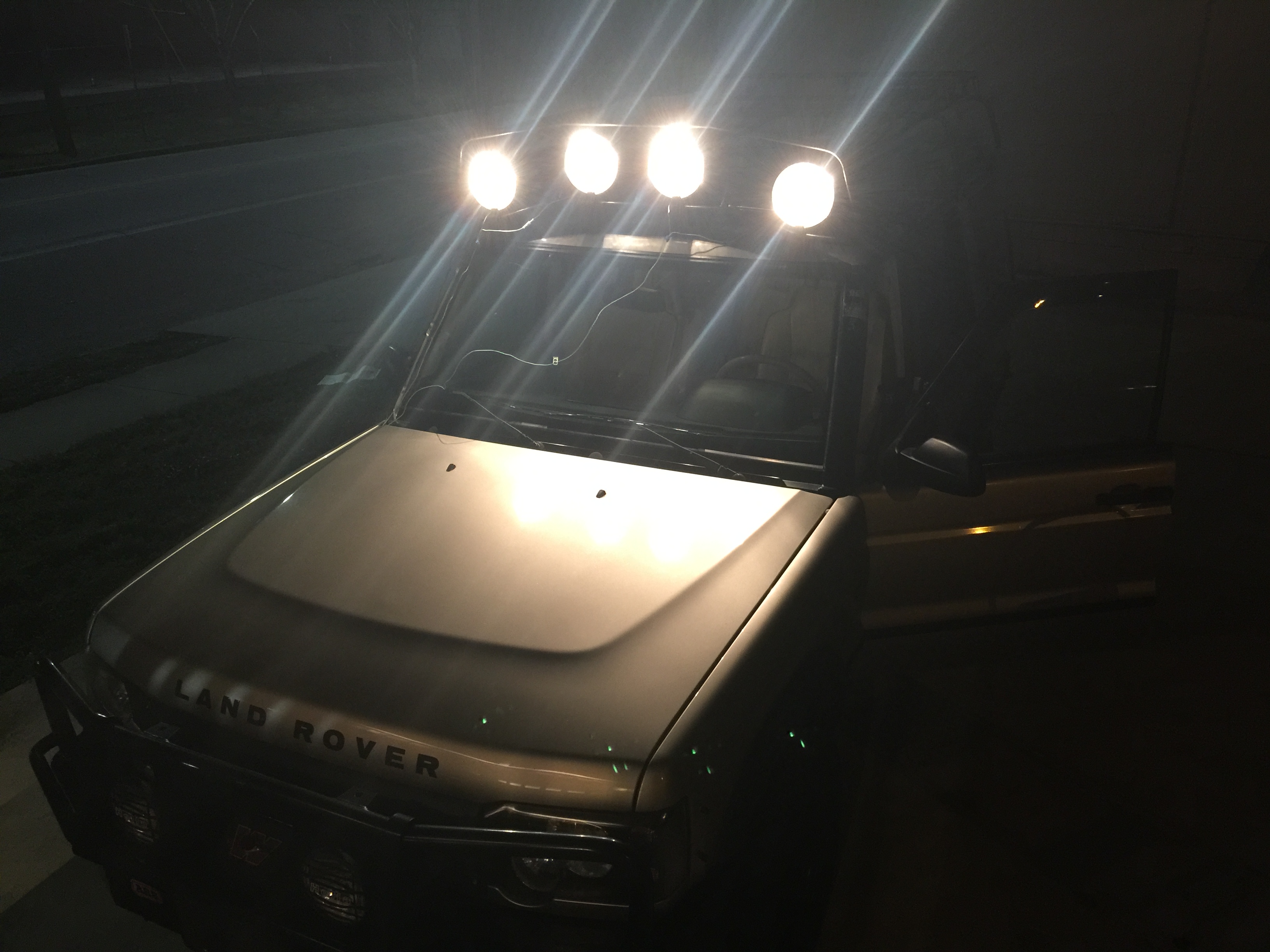

Default New AUX Lights
Installed some (old but new to me) Hella 1000's on the roof rack and a Work Lamp on the rear of the rack
