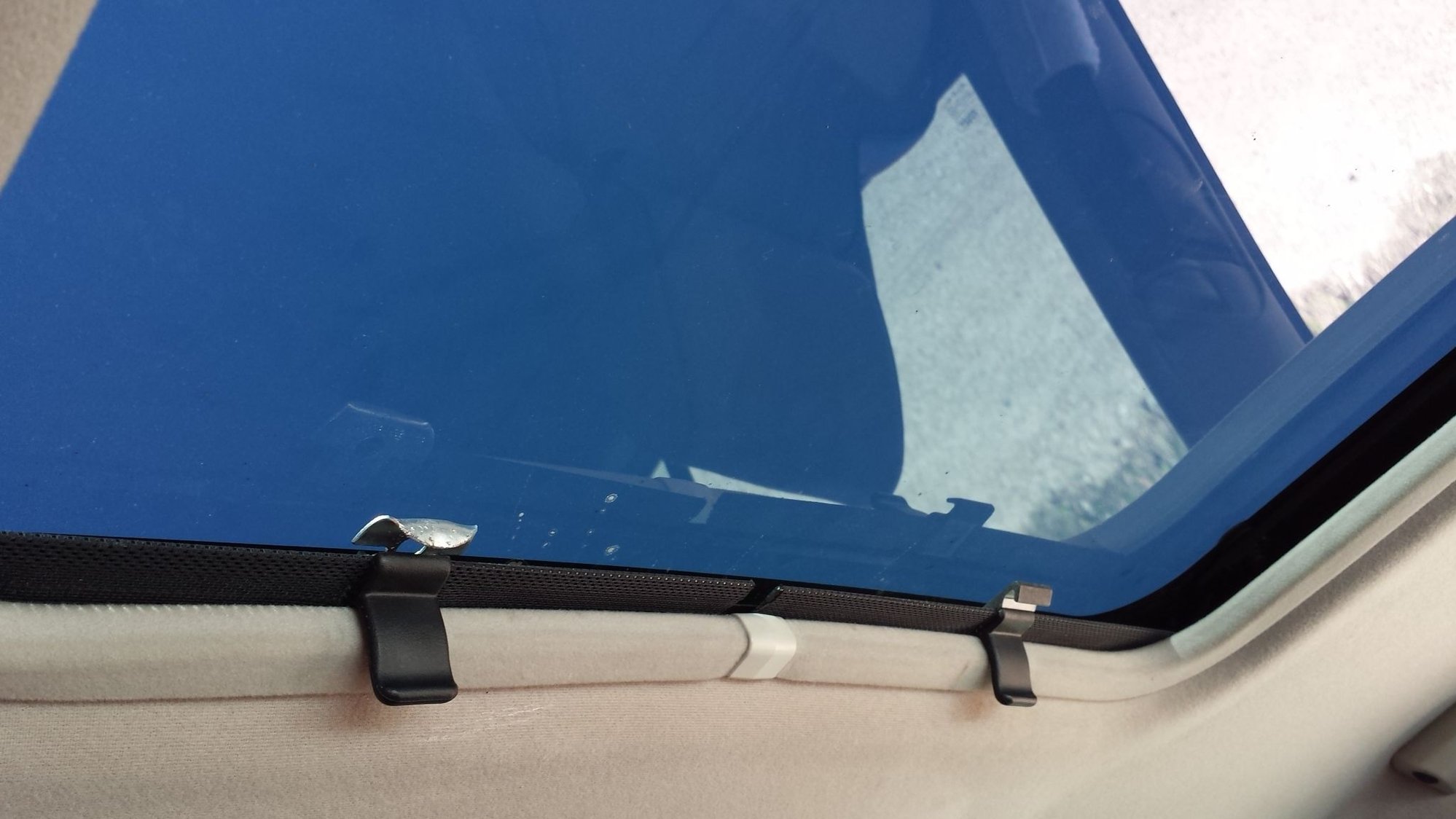

Fixed with a home depot washer and super glue.
Getting junk yard door ready to go on and replace my dented rear door.

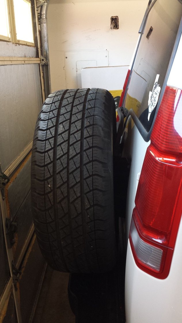

New door on and spare back on, but still looks way to close to the door, maybe my spare tire holder is bent a little too?

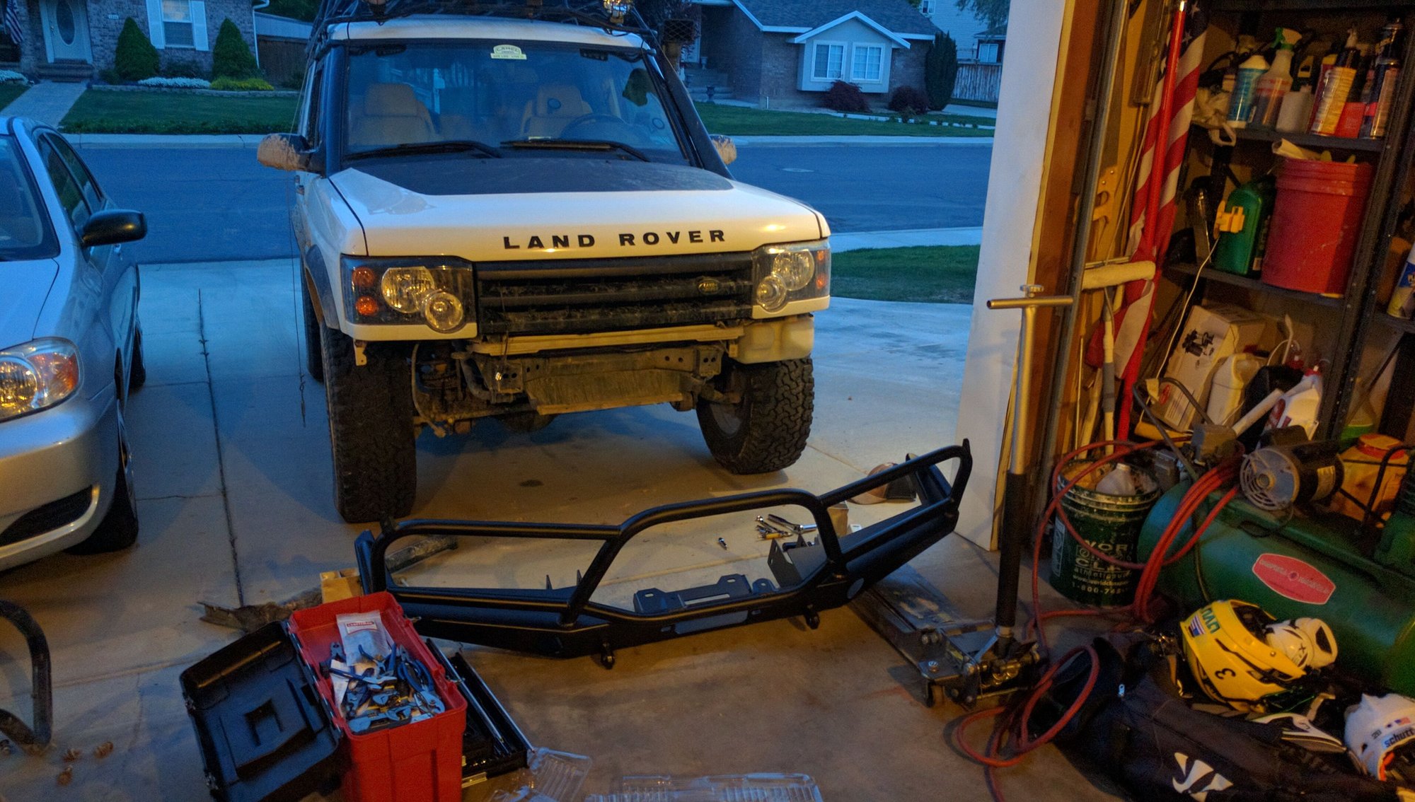

So I got myself a early Christmas present. I think it looks amazing.
