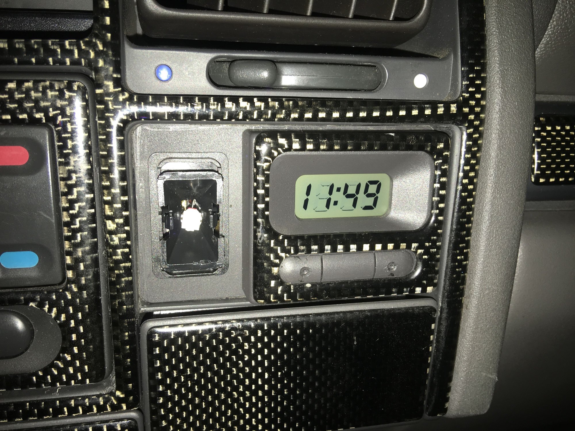

For the door lock switch ... I disassembled one of the ebay LEDs from the plastic T5 holder, I took apart the door lock switch, removed the old green LED (like in the pic below), soldered in the blue LED from ebay, reassembled the switch and installed it.
For the clock and the climate control it was a 1 for one swap of the bulbs for the new blue T5 LEDs. But for the clock, I had to totally disassemble it to remove the green screen so the blue LED could be seen through the clock.
The LEDs are dimmable from the driver's side dimmer switch with no mod needed.

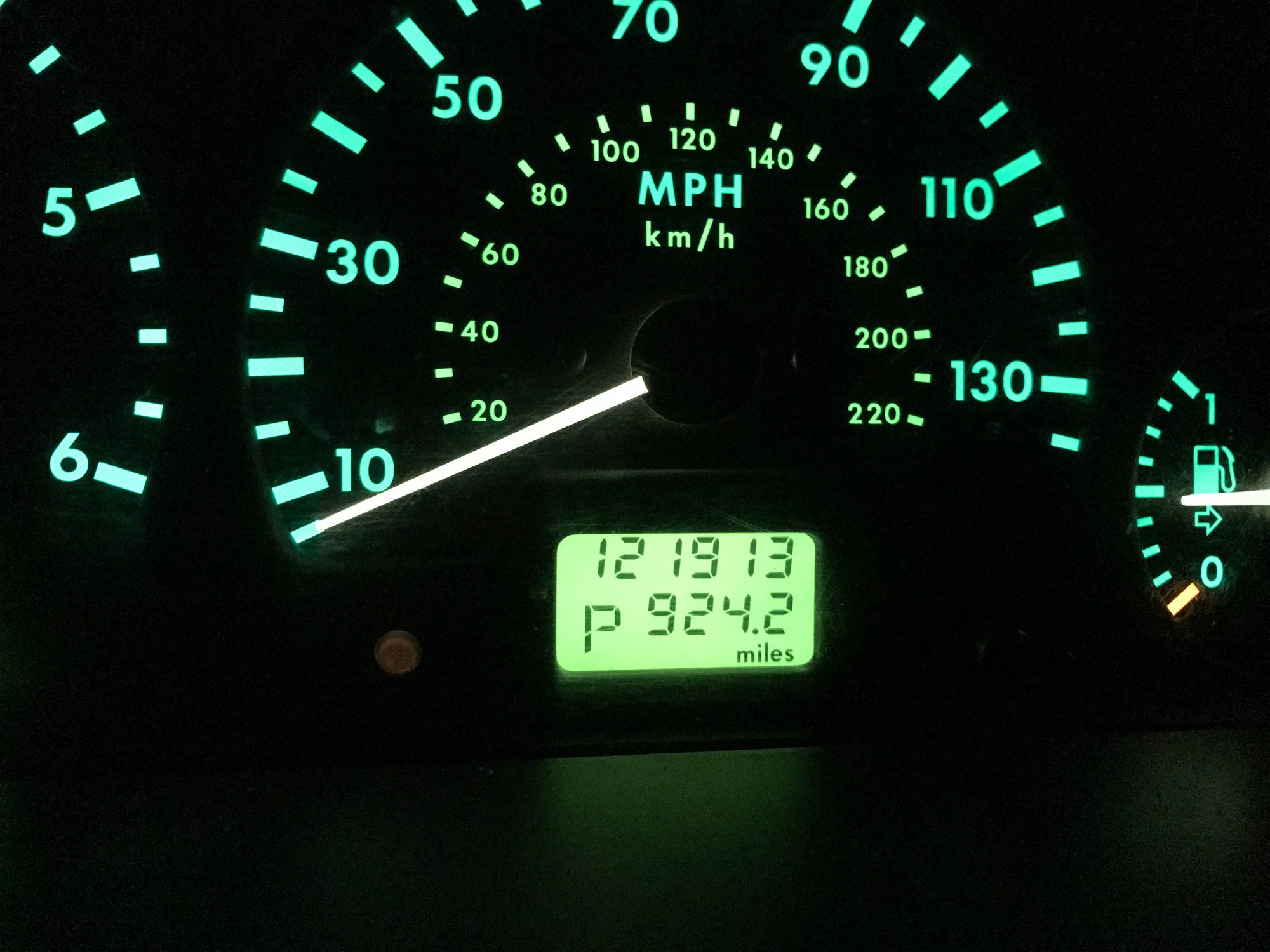

Did you finish the instrument change over? I found in my truck (2002) that the was a green condom cover on the bulb, but that the actually part that the gauge info is printed on has green tint where the light would shine through. Did you have that too? How do you plan on changing that to either clear or blue?
I want to change mine to reddish orange, like a GM or BMW. Amber/red light at night is easier on fatiguing the eyes, although harder to glimpse at and read information.
Hey Twix... doing the instrument panel is next on my to do list after I change the window button LEDs.
I'm kind of leary taking the instrument panel all apart. I don't want to bugger it up.
